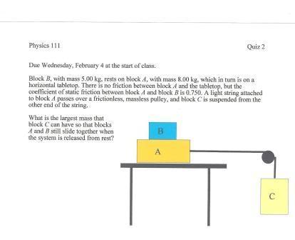

Blocks on a tabletop attached to a mass suspended by a pulley
In summary, the conversation discusses finding the mass of block C in a situation where it must move block A without overcoming the static friction between block A and block B. The equations f=ma, w=ma, and g = 9.8m/s/s are mentioned as being important. The conversation also mentions finding the static friction by multiplying the coefficient of static friction by the reaction/normal force, and finding the normal force as equal to the weight of Block B. The final answer given is 3.75 kg.

We have yet to go over this material, which kinda pisses me off, but I'm guessing that:
f=ma, w=ma, g = 9.8m/s/s
are important
If somebody could point me in the right direction that would be very helpful. I attempted at drawing a diagram of the forces on each object, but I'm not sure where to even start.
You want to find the mass of block C so that it moves block A but not too large that it overcomes the static friction between block A and block B I believe. So find the static friction and divide it by g to find the mass of Block C
static friction = (coefficient of static friction) (reaction/normal force)
So will the normal force be the mass of the two blocks times gravity?
the normal force should be equal to the weight of Block B
Thank you so much
I got 3.75 kg
