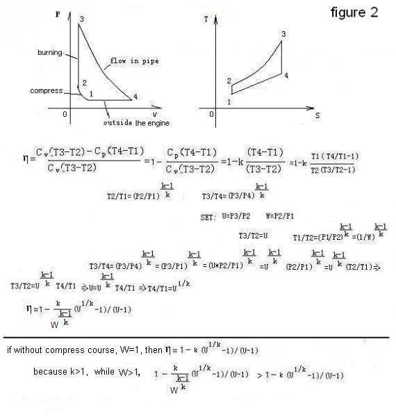

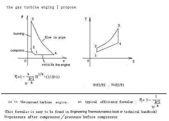

I can also compare the efficiency on two types of turbine engine by formula .
One is the new one I propose, the other one is the current one.
Pls read the attached figureEstimate the theoretic efficiency; compare the two types of engines: the current engine and I proposed.
Firstly I state some premises:
1. Because the efficiency of the current compressor and turbine in current turbo-generator is very high, the below calculation ignore the energy loss in them.
2. In below analyses I assume that the portion's efficiencies are same if they have the similar function component. Meanwhile I ignore some small loss during courses.
I set a sample example with data to explain, I assume the pressures are same before combustion in the two type engines.
for the current jet: efficiency=1-1/{W^[(k-1)/k]} ( ^N means the Nth power)
W: the pressure rise rate in compressor or blower; I set: W=10, k=1.4, the theoretical efficiency of the current jet is 48.2%.
As to the new jet: efficiency=1-k*[u^(1/k)-1]/(u-1)/{w^[(k-1)/k]}
W is increase rate of gas pressure by blower. W=10; here U is the increase rate of pressure by combustion, here U=4.5;I input the data, you can see the theoretical efficiency of this closed combustion jet engine is 60%
The efficiency of the new type engine is higher than the current one by 25%.
I try to explain why the new type of engine has more efficiency from another aspect, compared with current jet engine, the new engine uses up the same amount mechanical work and chemical energy but gets higher-pressure gas. The gas can make more work if its pressure is higher. So the new type engine has more efficiency.
The new engine can get higher-pressure gas because the gas pressure can increase further by the closed combustion course besides by the compressor that also is used in current jet engine.
b the way, pay attention, my contant-volume type turbine engine is different from the other contant-volume type engines.their thermal cycles are different basically.

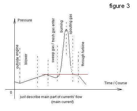

I have introduced the courses of the chambers, you can find the gas is intermittent to flow into one certain chamber.intermitent flow has many disadvantages. such as on energy loss, safety aspect and force load.in order to gas can flow stably and continously in front of chambers as possible as I can,I have to make the flow rotate, Thus I setthe branch pipes in front of the chambers, it is a pairs of the branch pipes(or a space has similar function) that are corresponding to the chambers while the gas enter. The branch pipes rotate with the front door. The branch pipes are short in order to reduce the energy loss.
the branch pipes do not cost much energy. The mixure gas before chambers always flows in high speed, Thus the gas is hard to burn, even though it has the trend, it has entered the chambers when it burns actually.
before the inlet brach pipes, there is big pipe after compresser.
so we encounter similar issue for gas out off the chambers, for a certain chamber, outflow is intetmitent; for whole chambers, outflow is alternately, I hope the final gas current become stable on speed and pressure comparatively. It is beneficial to work for gas by mechanism way, we can get higher efficiency and reliability. So I install one branch pipe corresponding to one chambers, the back door is set between branch pipes and chambers. the door does rotate. the branch pipes are fixed. on their other end the branch pipes converge into one pipe.By the branch pipes and a short period of time the gases expand, pass branch pipes and converge later, as well as a space works as a buffer storage which is after the branch pipes conjunction point , we get the target.
By this structure,the gas in very high speed in the branch pipes can cause negative pressure inside other branch pipes, so it has suck function to cause gas exchange (fresh gas enter and burnt gas flow out the chambers)in the other chambers.
firstly, I correct two sentences in the last post in order to explain more accurate.
"So I install one branch pipe corresponding to one chambers, the back door is set between branch pipes and chambers. the door does rotate. the branch pipes are fixed" ---corrected to "So I install one branch pipe corresponding to each chambers, the back door is set between branch pipes and chambers. the door does rotate. the branch pipes are static and mounted"
I have stated the principle of gas flow in side the engine , so i can draw the figue of gas condition in each process ,( including at each position in the engine).
The figure 3 shows the gas pressure at different courses (in different places), it is rough, and the exact details will is rather complicated. the figure just shows main portion of the flow. Please pay attention, there is a red horizontal line inside the figure, it shows that the pressure at two places have some relation. against the relation much, the engine can't work orderly.

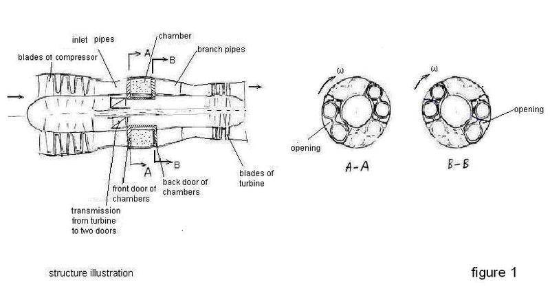

A sketch of your concept would be helpful, as the word pictures are not as easily grasped.
though i have mentioned key portion for the function when I introduce the main work courses. I still need to state the whole stucture of the engine.
pls study the figure 1.
The left one is the section view per axial, it show almost all main parts.
Another two pictures show the main parts: the front door and back door of the combustion chambers. two doors control and regulate works to complete combustion one by one. Anyone of combustion chambers sometimes sucks mixture gas; sometimes it the combustion happens inside it; sometimes gas exhausts from it. So the chamber sometimes is sealed by the two doors; sometimes it is open on both ends; sometimes it is open on one end. So the door has openings(slots) in it. The two doors rotate at same speed and co-operate each other.
At any time there is at least a pair of chambers in the same work course that are in the in symmetrical position.
As to the amount of chambers, I draw 4 couples here, actually it will be more. at least 6 pairs. It depends on the utilization rate of space; their strength; stable work and other factors.
There is a transmission( gas box) from turbine to the two doors, I set it because the two speeds do not match, I need to reduce speed a lot from turbine to the doors. the transmission unit will not ocuppy much space.
There is blower or compressor in front of the chambers. There will be also branch pipes in front of the chambers to input gas but they are very short so that they do not appear in the figure.
The branch pipe, turbine install behind the chambers. after a certain length of branch pipes, these branch pipes merges into one pipe. the turbine should be intalled within the converged pipe.
Later I will repeat or summarize the work courses of the engine.
Now I state the work procedure.
Let me introduce the new type of engine's work procedure: The first step of procedure is that the blower/compressor suck air and increase the pressure to a proper level; spray fuel into air afterwards or at the latter half of the compression; then through a certain length of pipe and a rotary short passage the gas enter the combustion chambers, the rotary short passage is eequivalent to the front door of the chambers. Meanwhile the burnt gas run out off the chambers. When the fresh gas occupies the nearly whole space of the chambers, the front door and back door begin to close. After the doors almost close, the inside mixture gas get ignited, the internal pressure increase rapidly, the combustion last only a few milliseconds and finished, then the back door open; the gas rushes out of chambers and into the branch pipes. thus the chambers begin to suck fresh gas and start the next cycle.
The chambers are arranged in a circle. There are at least a couple of chambers under a same course. This couple is on the symmetric position. Each chamber works per the sequence I describe upper. Because the front door and back door rotate, the courses change in turn on each chamber corresponding to the rotation.
The branch pipes are arranged in a circle. The gas flow into the branch pipes which position are symmetric. Later the currents merge and flow inside the general pipe. A turbine is placed afterwards, thus the gas strikes and drives the turbine which gets motion for the front blower/compressor, the rest kinetic energy of the gas is used to push the engine itself forward.
Inside the pipe/passage in front of the chambers, the flow is continuous.
The gas spouts out off chambers alternatively, (the spout is intermittent for a certain chamber), but the gases merge in one pipe and flow continuously at last. All the actions repeat with a very high frequency. It provides a consistent push force on the whole engine.
For each time of exchange gas inside chambers, the gases flow inside chambers are mainly driven by the negative pressure caused by high-speed current in outlet branch pipes.
Because the combustion in each time can finish within tiny little time, it is not necessary that chambers are closed completely at both sides, then we start ignition as far as the volume of combustion is almost constant.
If we analyze the principle of each course carefully, we can know how much time each course spends, we can distribute the proper percentage of space on the two doors corresponding to each course in a cycle in order to the engine can get very high work frequency. So the flow in the new engine will not be smaller than it in the current engine.even bigger than it. The flow is a important performance index for jet engine.
I set the compressor/blower before the combustion potion for this kind of jet engine, besides its advantage I have said, such as high efficiency, It has other advantages, by the compressor/blower the engine can work under different work condition as current turbojet , so it has the obvious advantage compare with some other new type jet, such as Ramjet engine

to etudiant
thank for your reply.
I correct you a little. the chambers do not rotate. the doors at the both sides do rotate.
you can not say " the doors don't need to be closed completely at both sides". It need or not depands on expriment. But i think at the beginning of combustion, the space can not completedly closed.
you also express you worry about something: heavy and heat. You can get result by search the topic to get my articles in other website. the chambers are arranged in a circle is relative to solve the issues. I also will explain my solution here later.

Continue to discuss the feasibillity,
Now I discuss the the structure and function of exhaust system, that including the branch pipes, general pipe and turbine.
The branch pipe, general pipe,the turbine install behind the chambers.
The function of branch pipes behind the chambers:
because I need energy to drive the compressor(blower) in front of the chambers, the common way is to install a turbine to receive the energy of the exhaust gas from the chambers. So I set a turbine.
When the burnt gas will go through the turbine, we need to keep the speed and pressure stable. It’s good to utilize the kinetic energy efficiently from the gas and is benificial for turbine to bear the load.
for a certain exhaust branch pipe, the gas spout intermittently, so the condition of gas inside a branch pipe is changable. I have to arrange these flows to cooperate to get a comparable stable current.
So I set a group of output branch pipes after the chambers. each branch pipe is corresponding to a chamber. then these branch pipes merge one general pipe. the turbine wheel is installed within the general pipe.
several pairs of chambers spout gas alternately and cooperate, we also can add a space behind branch pipes as buffer storage and to regulate gases before turbine, when the gases encounters the turbine, the condition is relatively stable.
These branch pipes have a certain volume space. when the gas rush out off the chambers, A certain volume of buffer storage can reduce the fluctuation.depending on the branch pipes, at last in the general pipe the flow can become comparable stable.
When the working course turns to exchange tha gas ,(ie,the fresh gas enters the chambers),the speed of gases in the corresponding branch pipes is the highest and the pressure is lowest at the end of the spouting course, the Momentum of the burnt gas cause the negative pressure inside the corresponding chambers, it can suck the fresh gas into chambers afterward.
Without the branch pipes, when gas spouts out, the current will influence the gas flow in the other branch pipes, such as the course of exchange gas . Installing the branch pipes; the course will help each other by the effect of suction.
The quantity, the shape and the size of the branch pipes should be studied carefully, They are relative to the functions I state upper. it is nessesary to do some experiments to while building the engine.
The shape of the branch pipe to genaral pipe should be designed carefully in order that the flows can cooperate well, the energy loss and flow resistance should be as possible as small.

I try to calculate the temperature before the turbine:
Pls see below figure 4: the figure show how I find their relationship of the main parameters in different course. (Sometimes I call constant-volume combustion type as closed combustion type)
Normally the pressure after compression is pretty high, if other things do not change, we make the pressure by combustion lower , the efficiency reduce a little, meanwhile the temperature before turbine reduce much,
I make a example: Set the temperature of outside air: 300K, k=1.4, set the pressure after compression/before compression α=7, the pressure after combustion/before combustion β=7.5, thus the temperature turbine 2206K; theory efficiency: η=60.2%; k=1.4, α=7, β=7, the temperature turbine 2100K, η=59.6%; k=1.4, α=7, β=6.5, the temperature turbine 1992K, η=58.9%; k=1.4, α=7, β=6, the temperature turbine1881K, η=58.2%;
Actually changing β is by change the volume proportion of fresh gas in each time or the concentration of fuel a little. In this example, η is reduced by 3%, the temperature before turbine decrease by 400K.
α and β all contribute to η. usually we expect the temperature before turbine not very high because of reliabity and life, thus in order to ensure a certain η, we need to increase α.
High temperature normally means high efficiency,but if it is too high, it will cause a series problem, it will influence the life and reliabity of the engine. Because the restriction, sometimes we have to make concession on efficiency.
This example just reminds the relation. The data to some parameters may not be so precise; Some modulus will change a little from in normal case to a very high temperature. Here I assume them unvaried for convenient study . Anyway it is a good enough reference for us.
The method also is used to calculate the temperature of each work course.
