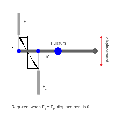

I have whipped up a really simple diagram to ensure I've captured what's going on.
Have I missed anything? Input welcome.
It does NOT contain the solution yet, it is merely the starting point. I'll modify it if anyone has any ideas.

What if you split the difference between the two points of contact, like this?
(hope that shows; I've never tried adding an attatchment before).
Anyhow, the two things that look like pneumatic cylinders could be repalced by springs. In theory, the mechanical advantage of each point of force would also be a mechanical advantage for the spring resisting that force. The point of force with the greater mechanical advantage would also have a resistance that has greater mechanical advantage. Wouldn't the two cancel each other out?
Clever-looking, but no. The blue points are still where the torques are applied and the device still moves.

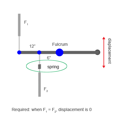

I would be useful to establish whether this is true or not, before everyone offers a zillion hare-brained modifications.
It seems to me there's no reason why it couldn't work. As simple a solution as a spring to dampen the force of F2 accomplishes what he wants in principle, would you agree?

How exactly would this not move? If F1 = F2 then the torque at the fulcrum from one direction would be double that from the other direction since the distance from the fulcrum and the points of applied force is double. The rotation would be counter-clockwise.
Perhaps I'm missing something.

The spring on F2 would absorb half of the force, balancing it with the force from F1. It's not meant to be the solution, merely to demonstrate that, in principle, there are ways to modify the forces.
But that's the thing: in principle the internal forces are irrelevant. It is the extrenal forces on the system that make the lever arm move or not move. You cannot absorb/redirect forces like this, it's a violation of conservation law. This is how perpetual motion crackpots are made - they look for ways to do exactly what is being looked at in this thread.
The spring still has an equal reaction force against the lever, regardless of the spring's displacement. For example, place a scale on a table top, then place a spring on the scale, then place a 1 lbf weight on top of the spring. The scale will still read 1 lbf (ignoring the spring's weight in this case). The normal force on the scale is unchanged (with or without the spring) even though the spring "absorbs" the force.

So where does the spring idea fail?
Take a look at post #21. When the spring has a force applied to it, the opposite end of the spring (where the lever is in your drawing) has a reaction force equal to the applied force. The spring's displacement (length) is just reduced. The magnitude of the applied force is still seen at the lever (i.e. the other side of spring). So nothing is gained from it.
CS
Take a look at post #21...
Sorry. Somehow I got behind a post or two. I wouldn't have asked if I'd read that.
