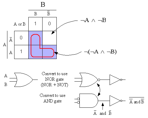

I find it's useful to use a Karnaugh map in these cases, since it let's you spot the simplifications and the complements visually.

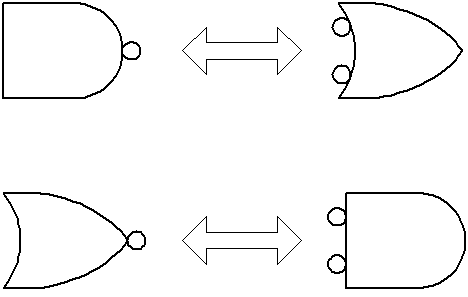

That being said, I also find it useful to remember that in digital circuits a NAND gate is equivalent to an OR gate with both inputs negated, and that a NOR gate is equivalent to an AND gate with both inputs negated. That is to say, simply move the 'NOT' circles from the front or back of the gate and change from AND or OR or vice-versa.

I suggested two tools that would allow you to "remember" how to convert ∨ expressions to ∧ expressions. Here they are converting A ∨ B to an equivalent using ∧:
