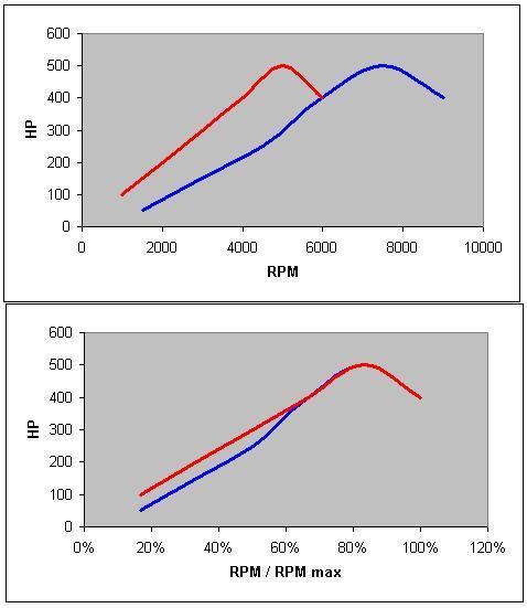

What if power is varying? For example, if we are using an ICE with a know RPM range (say 3000-6000 rpm) where, obviously, the power increases with the RPM.
Then what we care about is the AVERAGE power throughout the RPM range. No matter what is the extent of the RPM range.
Race cars (of any type) will try to maintain a very small RPM range across the peak power of the engine. Therefore, the average power will be very close to the peak power.
But if you take a more useful vehicle and you want to accelerate from standstill, dropping the clutch at 5000 rpm is not recommended such that you can get the peak power. So in such a case the POWER at low RPM becomes very important. Of course, the higher the power, the higher the torque; but what counts is the power.
For instance, a torque of 200 lb.ft@2500 rpm (=95.2 hp) will create a greater force at the tire's contact patch than a torque of 205 lb.ft@2400rpm (=93.7 hp), AS LONG AS THE VEHICLE SPEED IS THE SAME FOR BOTH EXAMPLES. (And for that, the gear ratio or wheel radius will have to be different for the two examples)
So to sum up:
To get the maximum traction force at the wheel (hence the maximum acceleration) at a given speed:
The whole torque curve: USELESS
Peak power: USELESS (unless you can run a very small RPM range and you rarely need to start from a standstill)
AVERAGE power throughout the USEFUL RPM range: DING! DING! DING! We have a winner!

I think I might be able to end the debate. It keeps going back and forth. Folks are using and changing terms, perspectives, vantage points, and it all gets pretty confusing.
I mentioned in another related thread, when I was asking this physics group, of what really came first, the HP or the torque. It got a little off track and then I think we all came to an agreement.
I started that thread out by specifically stating that power dictated torque at the rear wheels. Sure, you could figure it out in reverse as well, but generally, there is this argument of what is more important, engine torque or engine HP? Also, the misconception that torque gets you out of the turns and HP down the straight, (as well as hp sells cars, torque wins races) .
Basic physics 101 guys. acceleration = power/(mass x velocity)
This says acceleration is directly proportional to power and inversely proportional to speed.
He who has the most power at any given vehicle speed, will have the greatest acceleration at that speed (regardless if its out of the turn, corner, or down the straight), and therefor, the greatest torque at the driven wheels. No one can debate this. So, most all the talk then becomes relating to the shape of the HP curve over the operational range. (i.e. between all the gears). he who uses the most HP-seconds, will win the race in a straight line. (ignoring the drag racing factors and all other variables kept the same). this is the reason for close ratio gear boxes, and big beefy v8 and v10s with flat HP curves.
What I thought was a more philosophical debate, ended up being not really answered in the previous thread. The though was that it all started with power. doesn't the potential energy of the gas start the process? it rapidly expands as it combusts and pushes down on the piston, that heat energy is converted to mechanical energy (ie force). To the discussion, that can be applied to little tiny pistons that spin a small crank REAL fast. (like a porsche GT3RS engine with 500rwhp, spinning 9000 rpm) or a Viper with an engine making the same 500hp but with the engine spinning only around 6000rpm). Flat torque curve for the porsche, but peaky HP curve, vs the flat HP curve of the viper. who wins? depending on the shapes of the curves and the closeness of gears used, sometimes the viper, sometimes the porsche. But, both at ANY vehicle speed, if they are making 500rwhp, will produce the same rear wheel torque, (not engine torque, measured at the rear wheels) as would be measured at the wheels, after the gear reductions.
So, the bottomline is you want a powerplant that maximizes your HP-seconds. it can be done with big engine torque or small engine torque. if you are comparing two like engines, then you want the one that has more lower end torque, becuase it will have a flatter HP curve and produce more HP-seconds over the useable range.
My main question to the field here, is what other terms or equations can you use to approximate the time element in a HP curve. from a laymans perspective, you will be accelerating over a longer period of time as you run toward the top of the rpm range of an engine, that's why i though HP-seconds was a applicable term. what do the physics guys think or suggest to incorporate this time element into comparisons. area under the HP curve doesn't work completely for that reason.
Thoughts?
