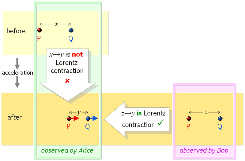

I think Bell claims that the distance between the ships does not change, but a rope connecting them gets shorter. That is wrong.
So it would break. So do you think Bell is correct for the wrong reasons?
My reading in the last couple of days leads me to conclude that the string breaks. Whether it breaks or not was initially of no interest to me. What was of interest was how such a proposed scenario could result in opposite outcomes when analysed by physicists who knew their subject. Perhaps I made the mistake of including some of the contributors to the discussion page of the Wiki entry on Bell's paradox in that category. However, I have learned a lot from it.

This is the standard on the paradox.
http://www.mathpages.com/home/kmath422/kmath422.htm
If I read it correctly though, the equations assume the string is pulled by the forward ship. What I do not see in the equations is the corresponding push by the accelerating ship from behind.
Also, here are some excellent papers on calculating the integral for constant acceleration.
http://math.ucr.edu/home/baez/physics/Relativity/SR/rocket.html
http://arxiv.org/PS_cache/physics/pdf/0411/0411233v1.pdf
http://www.ejournal.unam.mx/rmf/no521/RMF52110.pdf
I simply cannot see why the string will break though that is what most folks think.
If the perspective of the launch frame is utilized and the accelerations are perfectly the same, the launch frame applies the acceleration equations and sees the distance between the ships maintained perfectly.
But the electromagnetic forces between atoms in the string will be constantly changing, increasing the tension in the string until it reaches the breaking point. This should be true even if you analyze things wholly in the launch frame, although the details of such a calculation would be beyond me. Still, it's obvious they must change--just think of the case of two identical springs, one at rest in the launch frame and one moving at relativistic velocity, the equilibrium length of the fast-moving spring must be shorter than the equilibrium length of the spring that's at rest in this frame, due to Lorentz contraction. If there were no change in electromagnetic force between atoms as a function of distance in the launch frame, then the two springs would have the same equilibrium spacing between atoms in this frame and therefore the same equilibrium length.
I agree, the front part of the string will be pulled and the back part will be pushed.
Equilibrium will occur in the middle.
If it breaks, it would be on the front ship side between the middle and the front.
But, the launch frame in and of itself presents a problem.
For all t, the equations predict if d is the initial distance between the ships, then d wil be the distance for the ships during the acceleration.
You can see this in the links to the papers I presented by calculating x after any burntime in the proper time of the launch frame given a constant acceleration.
But why do you think this presents a problem? Presumably a detailed calculation of the inter-atomic forces inside the string done from the perspective of the launch frame would show that these forces depend on the velocity of the atoms as well as their distance, so that the tension in the string can be continually increasing even if the length (and the average spacing between atoms) remains constant.
Yea, I think of it another way and only from the front ship side.
Given any segment of the string, there exists a "gravity" potential difference between the side toward the front and the side toward the back.
Hopefully you agree the back side is not in play because of the reverse gravity potential difference.
Therefore, there exists a constant distance for the string to operate but a difference in gravity potentials given any segment of the string.
Now, the original solution claims the string stretches and then breaks without considering the back side and thus the distance between the ships apparently increases.
I would therefore say, it needs to be decided with this stretching in the front part, because of the gravity differential, what the maximum stress on the string will be.
Therefore, unless this string is of perfect rigidity, it is not decidable if it will break.

What do you mean "without considering the back side"? The distance only increases if you analyze things from the perspective of either ship's instantaneous inertial rest frame at different moments, the distance in the instantaneous rest frame will be increasing regardless if you are looking at the instantaneous rest frame of the back or the front (or of some segment of string in the middle).

But the pseudo-gravitational force only appears in an accelerating coordinate system, there is no such force observed in an inertial coordinate system like the launch frame. In any case, you really need to explain your ideas in more detail, I still have no idea what you mean by phrases like "without considering the back side" or "reverse gravity potential".

Assuming that the distance between two objects would be equal to the length of a rope stretched between them, what is the difference between "length contraction" and "space contraction"? It seems to me that if the "space between objects does not contract" then a rope stretched between them would not be contracted either.
It's not like a rope would stretch between two objects in their rest frame, but only reach part way as viewed from a different frame, because the rope contracted while the distance between the objects didn't.

Consider a uniform distribution of particles at rest along some segment of the x-axis of an inertial coordinate system x,t at the time t = 0. Each particle is subjected to a constant proper acceleration (hyperbolic motion) such that, with respect to its instantaneously co-moving inertial rest frames, the distances to each of the other particles remain constant

Here is the x for constant acceleration.
It is in the links I posted.
x(t) = c^2/a ( sqrt( 1 + (a t/c)^2 ) -1 )
Now, by adding 0, ie choosing the back back to initialize at 0 and x0 for the front rocket, you can readily see the x(t) is based only on a and t from the launch frame. Thus, the launch frame will not see a deviation with the distance between the rockets.

I was aware of the fracture for solving this problem.
I gave both sides to the problem, one by doing the integral in the instantaneous frame of the rockets and rope here
And, the other by viewing the problem from the launch frame using the constant acceleration equations of SR here
Then, I began analyzing the problem but Jesse does not want me to so I am going to stop.

Hello cfrogue,
I can asure you that my remarks were not aimed at you personally. I was commenting generally on the confusion amomg people, many of which I assume, are well versed in relativity.
My position is that from what I have read I believe that the correct answer is that the string breaks. However, I am as yet not confident in my ability to explain the reasons to anyone else, which of course is the acid test of understanding. I am also aware that there are variations on the scenario and so we may not all be singing from the same songbook.

That wasn't too obvious, because earlier you had suggested you wanted to focus on the launch frame when you said: "But, the launch frame in and of itself presents a problem." And "instantaneous frame of the rockets" is still too vague, the instantaneous frame at any given instant is an inertial frame so there will be no gravitational force in this frame, I think what you really mean is an accelerating frame whose definitions of distance and simultaneity at each moment match those of the instantaneous inertial frame at the same moment.
cfrogue said:
And, these are not my ideas.
I never suggested the idea of gravity in an accelerating frame was "your idea", but it is your own reasoning that leads you to the conclusion there is some doubt about whether the string breaks, since you have not pointed to any papers that mirrored your argument that the original paper failed to consider the "back side" (and you still haven't explained what you meant by that phrase), or that there is any disagreement among physicists that the string will break in the standard version of the problem.

You're talking as though "CERN" as an institution issued some official position about the rope not breaking, but this is obviously not the case--the article clearly states that Bell just took an "informal and non-systematic" poll of his colleagues at CERN, and that most of them thought it wouldn't break. He adds that many of them changed their mind (i.e. 'backed away from their decision') after further reflection, and I also quoted a paper that said "Though many of Bell's CERN colleagues originally thought the thread would not break, it is now universally agreed that it, indeed, will."
If you think there is any dispute among modern physicists about what would happen in this thought-experiment, you need to post some actual peer-reviewed literature, not a reference to an informal poll taken back when the idea was totally new. I am quite confident that there is no actual dispute about the fact that the stress increases, although as I said there could be types of accelerations where the stress increases but the string doesn't break (maybe because in certain types of accelerations the stress would approach a fixed limit rather than increasing without bound).

Neither I nor anyone else on this thread has disputed the claim that the distance will remain constant in the launch frame if both ships have the same coordinate acceleration in this frame. Again, the point is that the stress in the string will be continually increasing even though its length in the launch frame is remaining constant.
I think that the in LET the space between solid objects is considered not to contract and the contraction of solid objects is due to stresses or other effects between the interatomic forces. There are of course all the other complications with local time etc. required to make the theory work. In Einsteins' formulation everything contracts.
The reason I asked for confirmation of this is that some commentators on the paradox claim that the break/non-break outcomes are a result of the two differing approaches. I believe that the differing outcomes are due to faulty reasoning on the part of one side or the other. If the claims of those commentators are correct, then there would be an experimental method to decide between the formulations. If the two formulations are generally accepted, by proponents of both formulations , to be experimentally induistinguishable I would consider such claims for the reasons of the differring outcomesto be invalid.

No - the point is that the stress in the string will be continually increasing because its length in the launch frame is remaining constant.
Imagine two rockets separated by d=1 light-second, whereby the rockets are connected by a rope. In the launch frame the rockets accelerate simultaneously up to a velocity of 0,8c and therefore the distance between the rockets will remain the same. However, because of length contraction the rope (not the distance between the rockets) tends to get contracted to [tex]d/\gamma=0,6[/tex] light-seconds. This generates stresses within the rope, so it will break.
On the other hand, the observers within the rockets will note that the acceleration of the rockets was not simultaneous, so the calculation shows that after the acceleration the distance between the rockets is increased to [tex]d\cdot\gamma=1,67[/tex] light-second. Now, because the http://en.wikipedia.org/wiki/Proper_length" of the rope is still 1 light-second, the rope will also break in the (new) rocket-frame.
So in both frames the rope will break.

This paper does not dispute Bell's claim that the cable would break! Instead it calls for a rethinking of the reason the cable breaks...the author's argument seems to be that the only physical way of defining an object's length is by looking at its own rest frame, so that treating "length contraction" as a change in length is overly confusing...from p. 3:
This suggests the need for a definition of “length” that is the same for any state of uniform motion. This would correspond to the use in relativity of “proper time” and “invariant mass” for time and mass, but the terms “proper length” and “invariant length” have already been used in the literature with other meanings. The term we recommend for length is “rest frame length”, which we define as the length a moving object has after a Lorentz transformation to its rest system. If length is to be considered a physical attribute of an object, then this physical attribute should be the rest frame length. This length, of course, would not be changed by uniform motion.
The author then points out that the "rest frame length" of the cable or string does grow as the ships accelerate, even though the distance between them in the observer's frame does not change, and that this should be seen as the true reason a cable or string would break, not length contraction:
Although the spaceships are accelerating, the system S′ is a Lorentz system moving at constant velocity. Since each ship is instantaneously at rest in this system, the length d′ = gamma*d is the rest frame distance between the ships. As such, it is the physical distance between the ships. If there were an inextensible cable between the ships, it would snap at the start of motion of the ships. An elastic cable would stretch until it reached its maximum possible length dMax, at which point it would snap.

There is no doubt about this. In the launch frame the distance between the ships is constant. You gave a valid explanation at the end of post #18.
If the string was attached to the front ship only, trailing behind it, it would initially be touching the back ship, but as soon as the acceleration begins, the length of the string contracts as measured in the launch frame (assuming its "rest length" remains constant i.e. its length in any frame in which it is momentarily at rest).
Therefore if you had attached the string to the back ship, if the string was elastic it would stretch and if it couldn't stretch it would break.
I think this agrees with what everyone else has been saying in this thread and what the quoted paper says.
There is certainly no disagreement amongst experts that the string will break (despite the fact that long ago some experts initially got it wrong when they heard of the problem for the first time; even experts can make mistakes occasionally but now there is consensus as to what the correct answer is).

In the launch frame the string won't experience any change in length until it snaps. As I've said, the stress in the string will increase though. I think when people cite "Lorentz contraction" as an explanation for the string breaking, what they're getting at is that the string "wants" to contract but can't because it's attached to the ships...it may be easier to make sense of this if we think of a spring rather than a string, since you may remember from classical mechanics that springs have a "rest length" that they naturally assume when nothing is pulling or pushing on them (the rest length minimizing the stress in the spring), and that when they are pulled to a greater length than the rest length they pull back with greater and greater force, as if they are "trying" to return to that length (and obviously if you pull a spring far enough past its rest length, it'll snap). If you had two identical springs traveling alongside each other, one attached to the two ships and one with its ends free whose length was equal to its rest length, then the length of the free spring would grow shorter and shorter as seen by the launch frame as its velocity increased, which implies that the spring attached to the ships, whose length does not change in this frame, is being extended farther and farther past its own natural rest length.
