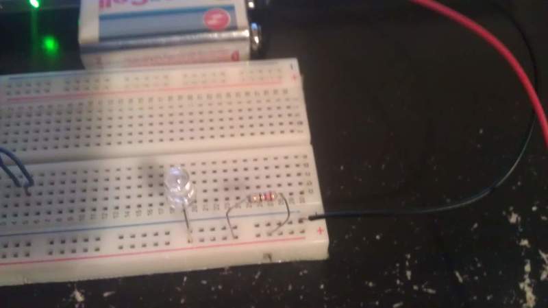

As the title states I am really doubting Ohm's law. This is why: On a breadboard I placed a white LED and a 220Ω resistor with the 9v battery all in series. The total current flowing through the circuit shouldn't be more than 41mA by V=IR, but my multimeter points between the range of 150-120(Edit: mA). Can someone tell me why?

anj16, can you take a picture of your setup?

I have attached a picture of the setup

Isn't the entire + line connected on the breadboard? If so, your resistor is shorted out. Try checking resistance while it is in the breadboard.
Thank you so much! I never thought about that. I think I need a break from this ;)
EDIT: Also the doubt I had is gone because I re-measured the current and it comes to about 41 mA.
prob solved ...
the old saying ... a pic is worth 1000 words ;)
