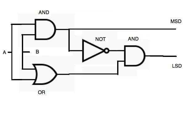

It would be nice and really helpful if someone could show me that how a CPU add 1+1 to 2 or subtract 1-1 to 0.
Thanks, JT. If that's what I'm supposed to know first, then I will read them and come back soon. I have some knowledge of the gates but don't understand half-adder and full-adder circuits.
I just whipped up something that can add 1 plus 1:
Does this make sense?

For arithmetic you use what is known as "adder" circuits. They work just like the way you add numbers in base 10 except that a computer uses base 2. It takes two bits computes the result and also the carry bit. You basically have a chain of these to calculate the full result and the number of adders is basically the number of bits that is the size of the number your adding.
Things that compare use logic. Let's say you want to see if a number is a certain number and if its you do something. You can take the value in some register and subtract your 'number' from it. If it equals zero then you do something. One way we can test this is to invert the bits of the result and then compute the result bit to be (bit0 AND bit1 AND bit2 ... AND bitn) which will give 1 if true and 0 if not. Then this bit is used to do something.
A way to say compare if one number is greater than the other with unsigned bits is to simply do a subtraction involving two words with the CPU using n+1 bits and then checking the sign bit at the end of the computation. If you want to know how signed bits work look at "2's complement" on wikipedia.
So in a nutshell arithmetic is done using adders and with multiplication you just use AND gates as well as adders in exactly the same way you do multiplication using pen and paper.
When you use comparisons you basically use a formula that sets a bit to some state (1 or 0) to represent if the comparison was true or false.

The logic gates AND, OR, etc. are simply 'mathematical' or 'boolean' objects and in real life are implemented through circuits made from transistors. Right?
So, if this is possible to explain to me with the limited extent of knowledge, then would you please tell me how some circuits would be implemented to get "01" (which stands for '2') once the two inputs of the circuits are '1' and '1', i.e. 1+1=01 (in binary)? Could you please help me? If this seems a complex problem to explain then you could choose some less complex example to explain what I seek to know. Thanks a lot for the guidance and your time.
AND, OR, and XOR logic can be created from NAND or NOR gates.
Wiki article about NAND gates, second link includes diagram of simple adder:
http://en.wikipedia.org/wiki/Nand_gate
http://en.wikipedia.org/wiki/NAND_gate
The same thing could be done with NOR gates (although NAND gate based logic would be more common):
http://en.wikipedia.org/wiki/Nor_gate
http://en.wikipedia.org/wiki/NOR_logic
To store and hold data you need a latch (flip flop) for each bit:
http://en.wikipedia.org/wiki/Latch_(electronics)
To implement a true multi-bit adder, you need an adder that includes 3 bit inputs, the two input bits plus the carry bit from the lower order add bit.
http://en.wikipedia.org/wiki/Adder_(electronics)
