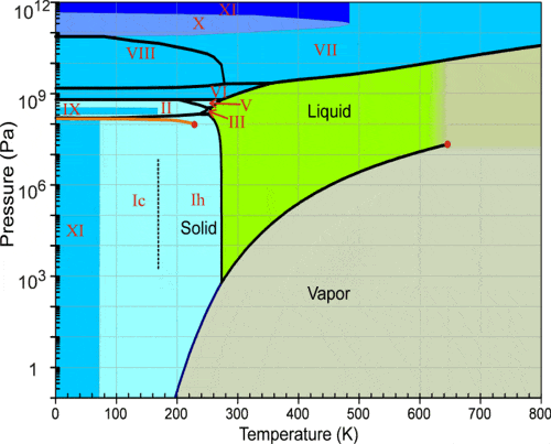

There are actually almost a dozen forms of ice water. Ice I (naturally-formed water-ice) is only one.
A good rule of thumb is that if any solid phase has a smaller molar volume than the liquid phase(s) (and I don't know of a material where this isn't the case), then the material will freeze under pressure, regardless of temperature. It's the energetically favorable thing to do.
To add to what DaveC says, according to this chart, at 300K, or 27C, water is a type 6 solid at 10^9 Pascal pressure.
As you might recall, water expands on freezing. But pressure acts to reduce volume. This is the opposite of what you would want to get it to crystalize in the normal manner. Under higher pressure, at room temperature, water is a different form of solid--whatever type 6, 8 9 and 10 are.

So, we couldn't have oceans deeper than 100 km on Earth because the water at the bottom would freeze under pressure.

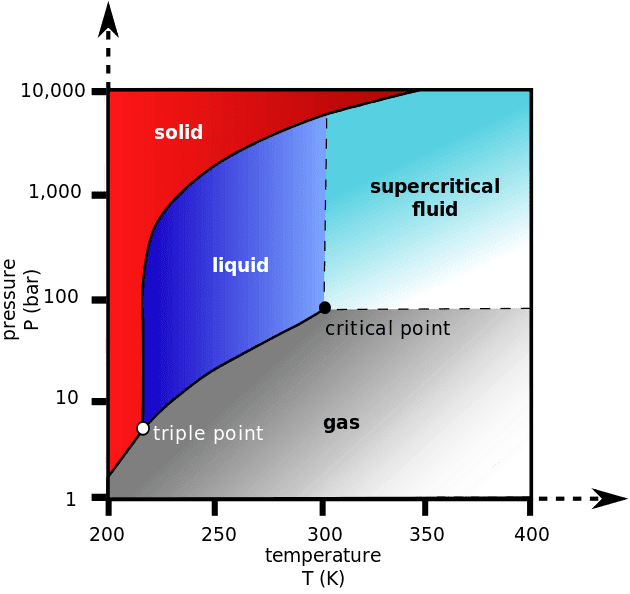

This is an easier phase diagram to understand
http://www.jamstec.go.jp/xbr/2deepstar/02deepenv/figures/page24_blog_entry6_1.png
So the answer is, it depends on what you call freeze and what temperature you're at.

im pretty sure if you look at the triple point chart that chmdude has up it tells all you need to see. increasing the pressure, you cannot make ice. But if you look in the bottom left, apparently you can increase the pressure of steam to make ice.
but here is carbon dioxide and you can increase the pressure of this to phase change it from liquid to solid
ahh i see, so the chart above just didn't go to a high enough value along the y-axis.?
It's a weird case, where pressure could cause ice (normal ice, in a hexagonal crystal structure) to melt into water, then resolidify at enormous pressure in a different crystal structure, all at a temperature of 0°C. Pretty amazing.
Exactly. What we call "frozen water" isn't the only solid form of water, it's just the crystal structure that happens to form at atmospheric pressure. If you compress anything below its supercritical temperature it will eventually become solid (or a glass).
However, are you sure your phase diagram is accurate? IIRC once you pass the supercritical points of temperature and pressure, that is all that exists. I could be wrong and/or my P-chem professor left something out.
The supercritical point is just a point where the line of first order transitions between liquid and vapor ends. The critical point itself is point where there is a second order transition. There the heat capacity diverges with a certain universal critical exponent.
But this has nothing to do with the other phase transitions in the phase diagram.
