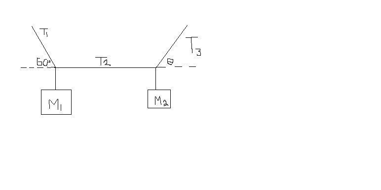

The system (picture found in attachment) is in static equilibrium, and the string in the middle is exactly horizontal.
Find
a. Tension T1
b. Tension T2
c. Tension T3
d. angle (theta)
sin=opp/hyp
cos=adj/hyp
a. Using Ty = T1sin60 - mg = 0, T1=34 N.
b. Using Tx = T2 - T1cos60 = 0, T2 = 17 N
c. Eq'n 1: Tx = T3sin(theta) - mg = 0
Re-arranged to: theta = cos-1 T2/T3
Eq'n 2: Ty = T3sin(theta) - mg = 0
Then I substituted the re-arranged eq'n (1) into eq'n (2), and I got this:
0 = T3sin(cos-1 T2/T3) - mg
However, I don't know how to solve this ... so I think I may be doing something wrong.
Thank you in advance for any assistance!

I have added the attachment to this post...hopefully it works this time!
Parts (a) and (b) look OK.
Part (c)
If you draw the FBD for the mass m2, you get
T3sinθ - m2g = 0
- T2+T3cosθ = 0
So T3sinθ = m2g
and
T3cosθ = T2
These are the horizontal and vertical components of the tension. Can you find its magnitude?
Thanks so much for your help :)
Using the following equations:
1. T3sinθ - m2g = 0
2. - T2+T3cosθ = 0
I re-arranged and substituted eq'n 1 into 2, and then calculated theta=49o.
The only thing I wasn't sure about was when I had cos(theta)/sin(theta), I simplified it to 1/tan(theta). Is this the correct was to use the trig identity tan=sin/cos ??
Then I substituted the calculation for theta to calculate T3=26 N.
Your method is fine. What I was hinting at is that if you know the x and y components of T3, then the magnitude is given by
T3=[T3x2+T3y2]1/2 = [(m2g)2+(T2)2]1/2
and, as you pointed out, you get the angle from
tanθ = T3y / T3x = m2g / T2
Okay I see what you were saying - but you get the same answer either way, correct?
Correct.
