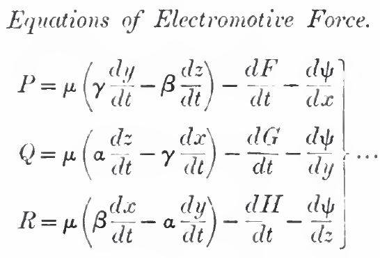

In summary: Maxwell's equation for electromotive force (equation D in the paper): "electromotive force" and "electric field" are synonymous. For in the equation, electromotive force at any point is a vector quantity, and it gives rise to current; that is the definition of an electric field.

As I read Maxwell's equation for electromotive force (equation D in the paper), it seems to me that "electromotive force" and "electric field" are synonymous. For in the equation, electromotive force at any point is a vector quantity, and it gives rise to current; that is the definition of an electric field.
Here is why I do not understand Einstein's claim that no magnetic field arises in the vicinity of the magnet: In the equation for electromotive force, the first term is the product of the strength of the magnetic field and the velocity of the conductor relative to the field. Thus, when the conductor moves and the magnet is stationary, electromotive force increases. Electromotive force is a synonym for electric field. Therefore, the movement of the conductor in the magnetic field gives rise to an electric field.

There are three terms in Maxwell's equation for electromotive force:
[velocity of conductor] times [magnetic intensity at that instant]
rate of change of electromagnetic momentum (accounts for movement of poles, or change of intensity of stationary poles)
rate of change of electric potential
All three terms are vector operations. He presents the one equation as a set of three differential equations. I haven't done that kind of math in close to 30 years, so I don't pretend to understand the equations completely. I think I get the gist.
I'm guessing that in the Lorentz equation, v x B covers the first two terms of Maxwell, and E covers the third.
The first term of Maxwell can be eliminated if one chooses to put the origin of the coordinate system on the moving conductor. Then the electromotive force will be due to the change in magnetic intensity, from the second term. This is a trivial transformation--no need for the Lorentz transformation, and no need to make a fuss over it, in my opinion. Seems to me that Einstein had a deeper objection to the asymmetry than that.

Part of my difficulty in understanding Einstein's claim of asymmetry is that Maxwell never uses the term "electric field" in any of his published papers. (That claim is true if a search of the pdf file is to be trusted.) I have not seen "electric field" in the 1864 paper on electrodynamics. He talks mostly about the electromagnetic field; sometimes he says magnetic field; once (in On Faraday's Lines of Force) he says magneto-electric field.
Maxwell does talk about electromagnetic force. As noted earlier, Maxwell's electromotive force is a vector quantity at any point in space that forces movement of electric charge. My understanding of an electric field is precisely that: a vector quantity at any point in space that forces movement of electric charge. If my definition of electric field is correct, then I believe I am on solid ground when I say that the equation for electromotive force is the equation for the electric field.
In that equation, there are three contributors to the electric field at any point: motion of a conductor, change of intensity of magnetization (includes motion of a magnetic pole), and change of electric potential. So for Maxwell, movement of a conductor in a magnetic field produces an electric field, as does movement of a magnet. Here is the equation (in three parts) for electromotive force, from the paper:
Maxwells' explanation:
The first term in each equation represents the electromotive force arising from the motion of the conductor itself.
The second term in each equation indicates the effect of changes in the position or strength of magnets or currents in the field.

I'd like to go back to my understanding of the electric field, and Ben's response.
Me:
For the electromotive force that the equation predicts has exactly--no more, no less--the characteristics of an electric field: a force vector at any point in space.
Ben:
This is wrong. A field isn't defined by the existence of a force.
No, not in general. But I was talking about an electric field, which is a force field, as I understand it.
From Georgia State University:
Electric field is defined as the electric force per unit charge. The direction of the field is taken to be the direction of the force it would exert on a positive test charge.
From the Physics Classroom:
The direction of the electric field is always directed in the direction that a positive test charge would be pushed or pulled if placed in the space surrounding the source charge. Since electric field is a vector quantity, it can be represented by a vector arrow. For any given location, the arrows point in the direction of the electric field and their length is proportional to the strength of the electric field at that location. A more useful means of visually representing the vector nature of an electric field is through the use of electric field lines of force.
It seems pretty clear that force is at least a component of the electric field. Is there some other component in addition to force?

The result of the electromotive force equation in Maxwell's 1864 paper must be the electric field.
In that case, why would Einstein say that there is no electric field when the magnet is stationary and the conductor moves? The first term of the equation says that there is an electric field due to the motion of the conductor in the magnetic field.
Because it is correct. There is no electric field when the magnet is stationary.
Which equation?
The electric field is the electromotive force which would be on a unit charge at a given location if there is a charge present.
Experiment shows that there is an electromotive force at a given location when the magnet is stationary and there is a conductor moving.
Therefore, experiment shows that there is an electric field when the magnet is stationary and there is a conductor moving.
DaleSpam said:
Which equation?
See #14 above.
The equation is for electromotive force ay any point. So, by the definition of the electric field, it is the equation for the electric field.
In this equation, the first term is the contribution to the electric field from a charge moving in the presence of a magnetic field. The second term is the contribution to the electric field from a moving magnet. If by this equation a moving magnet produces an electric field, then by the same equation a charge moving in the presence of a magnetic field also produces an electric field.

I don't think I made myself clear. I'll try again.
1. The electric field is the electromotive force at a given location that hypothetically *would* act if a charge were placed there. [The italics are from BCrowell's response a few posts back.] The point is that the electric field is the map of the electromotive force, irrespective of the agent(s) that bring about the force.
2. Experiment shows that there is an electromotive force when a magnet is stationary and a conductor is moving. The electromotive force is acting on the charges in the conductor. Considering a single charge in the conductor, experiment shows that there is an electromotive force at a given location when a charge is present and moving.
3. Therefore, experiment shows that there is an electric field when the magnet is stationary and there is a conductor moving. [There is a charge; there is electromotive force on the charge; by definition there is an electric field.]
The three statements above are presented as proof that there is an electric field present when the magnet is stationary. In short: It has been said that there is no electric field present when the magnet is stationary. I respond, give me a magnet and a conductor and I will demonstrate that there is an electric field.
The notation is archaic, and I don't know what all the variables are, so I cannot comment much on that equation. However, only three variables could possibly be the components of the electric field, and there are more than three variables. So clearly, the mere fact of an electromotive force does not imply an electric field by that equation either.
Addressing the text in bold: The electric field is defined as the map of electromotive force. By definition, then, the mere fact of an electromotive force is the very same thing as an electric field.
Consider the case when the magnet is moving and the conductor is stationary. The assertion is that there is an electric field. On what basis is the assertion made? On the basis of an observed electromotive force. In both cases, electromotive force is observed. Why is the observed electromotive force taken as proof of an electric field in the one case, but not the other?
You were clear, just wrong.
Close, but not quite. The electric field is proportional to the force that would act if a stationary charge were located there.
Yes.
No, there is an electromotive force on moving charges, which is not the definition of an electric field.
Not if you move the conductor.
The electric field is a map of the electromotive force on stationary charges, so the mere fact of an electromotive force on a moving charge is not the very same thing as an electric field.
Because the charges are moving in one case but not the other.
In modern notation the electromotive force, aka the Lorentz force, is given by:
[itex] F = q (E + v \times B) [/itex]
Note that this force consists of a term arising from an E field and a velocity dependent term arising from a B field. If you want to claim that an emf is only due to an E field, then you must get the B field term to drop out, which happens if v=0.

Okay. I did not realize that the electric field applies to a stationary charge.
In the Maxwell equation for emf, the second and third terms will be included in E. These are the forces on a stationary charge from a change in the magnetic field and from the potential gradient. The first term is v × B.
Even with the knowledge that the electric field applies to a stationary charge, I am still at a loss to understand Einstein's statement, "In the [moving] conductor, however, we find an electromotive force, to which in itself there is no corresponding energy."
Clearly, the energy for the emf on the charges in the moving conductor comes from the magnetic field through which they are moving: v × B.
If Einstein has a legitimate quarrel on that point, it is not with Maxwell. Maxwell attributes the cause of the emf to the magnetic field, regardless of whether the charge is moving through the field or the field is changing in strength (as when a pole moves):
This, then, is a force acting on a body caused by its motion through the
electromagnetic field, or by changes occurring in that field itself; and the effect
of the force is either to produce a current and heat the body, or to decompose
the body, or, when it can do neither, to put the body in a state of electric
polarization...

Einstein says that the force from the B field is the same as the force from the E field, given the same relative velocity and distance. If the forces and paths are the same, how can the integrals of force over path be different? (The appropriate answer to this may be, "Go read this book.")
DaleSpam said:
Although the energy does come from the B field, the force and the B field are not the same thing and are in fact not even proportional. So the fact that the B field does have energy "in itself" does not contradict the fact that the force from the B field does not.
Without contradicting you, I will note that the first term of Maxwell's equation for emf (the term which deals with a moving charge) consists entirely of the addition and subtraction of terms of this form:
(magnetic intensity along a coordinate axis) * (velocity along a coordinate axis)
On inspection, it appears as though the force is proportional to the strength of the magnetic field. (Again, the appropriate answer to this may be, "Go read this book.")
At any rate, given that the two emfs are the same, as Einstein says they are, it seems to me that Einstein's complaint is along the lines of a legal technicality, and of no practical consequence.
I have been wondering why he did not directly raise the issue that Maxwell requires the velocities of the magnet and conductor to be reckoned relative to the ether, rather than relative to each other. Perhaps the issue he raises (the emf on the moving conductor not having energy in itself) resolves to the larger issue of velocities being reckoned relative to the ether, instead of relative to the bodies under test. I note that in the body of the paper he transforms the coordinates (including time) of the moving conductor to the frame in which the conductor is stationary, taking into account only the relative velocity of the conductor and magnet. It would not be possible to do this (and get the correct answer) if the force is transmitted by the ether, and both the magnet and the conductor are moving relative to the ether.

That is essentially his point. The equations are non relativistic, but the phenomena are not.
Look, the mathematical fact is that Maxwells equations are non (Galilean) relativistic. The historical fact is that scientists of Einstein's day were aware of that. What else is relevant here?
