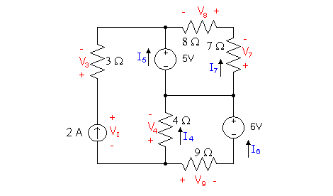

Thanks for the responce, but why did they choose the longest loop? that's my confusion, how do you know which path to choose to figure it out? Perhaps someone can explain it easier on this picture:
okay they say:
Below are the 5 Ohm's Law equations needed.
V3 = 2 x 3
V4 = 4I4
V7 = 7I7
V8 = 8I7
V9 = 9I6
If the top node and the bottom node are selected, these are the resulting KCL equations:
Top Node: -2 - I5 - I7 = 0
Bottom Node: 2 + I4 + __ = 0
Okay it all makes sense but why does V8 = 8*I7 and not 8*I5? how did they know I5 didn't take a right and go through V8? also V9 = 9I6, why couldn't I4 go through V9? And what are they talking about Top Node and bottom node?
KCL says, current in a junction = current out of junction. So why are they saying -2-I5-I7 = 0? all those currents are going INTO the junction so wouldn't those be postive? also when they say bottom node, 2+I4 + ? = 0, why are those postive? the question mark should be I6, which is correct, 2+I4+I6 = 0;
In this format, EACH branch (the part of a circuit from one node to another) gets its own label for current ... the Voltage across R8 is BY DEFINITION = I7*R8.
The statement -I7 = I5 + I2 means that I2 and I5 go into this node (solder spot) , and -I7 comes out.
I like to use "reasonable guess" for the directions of the current, but
it's okay to use the format you have started ... in words, it means that
the total current coming out of a node = 0 ... or the total into a node = 0.
ANY path you choose will give you a "correct equation" (if you do it right).
with practice, you tend to choose a path with the fewest unknowns.
Otherwise, just choose systematically different paths, and deal with the
multiple equations with multiple unknowns as simultaneous equations.
It works, but is harder math.
