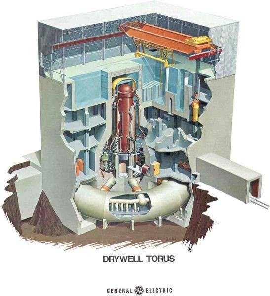

The upper level of containment, the metal walls and roof, was destroyed. That structure is over the inner containment, which is reinforced concrete. I believe the reinforced containment had the pressure increase, which was vented. The venting would be through those stacks (towers) that one sees behind (to the west of) the units. Venting into the upper containment would not be the case as far as I know.alxm said:NHK English is currently reporting that the hydrogen explosion didn't rupture the containment vessel. (Albeit the outer wall of the building) From what I know of these things, that's pretty much where it would be expected to happen - given that they try to vent the steam 'under the dome' rather than to the outside?
