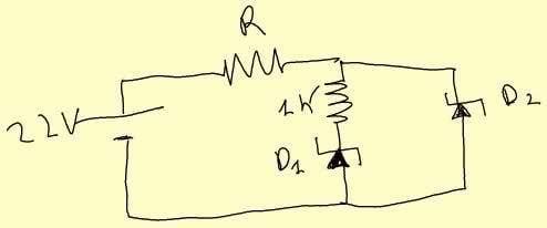

So to secure ideas, i am going to consider another circuit, this one:
Imagine that we can change the value of the R resistance, and at the start is very high so there isn't conduction in the circuit , if we diminish its value ¿both branches will start to conduct at the same time (both zener with the same properties)?
