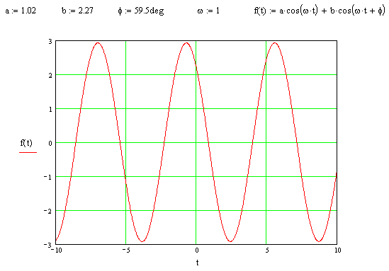

gneill said:
Is the resultant amplitude 2.86, according to the plot? It is close but different.
ehild
I've been looking more closely at the OP's formula. It would appear to be a good approximation for small phase angles, say less than 50 degrees or so. I'm currently investigating a derivation that will provide an error term.
ehild
The plot maxima are at amplitude 2.92 ! So yes, close to 2.86, but not spot on. Your formula delivers the goods (as it should, based upon the derivation!).
