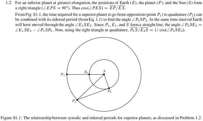

Determine the relative distances of each of the planets from the Sun given [ ].
In summary, the problem at hand is to devise methods for determining the relative distances of each planet from the Sun using the available information of observable angles between the planets and the Sun, orbital configurations, and synodic periods. This can be achieved by observing the maximum angle between the line of sight to the Sun and the line of sight to an inferior planet at greatest elongation, and using trigonometry to calculate the relative distances. For the case of a superior planet, one can determine when it is at quadrature by observing when the line of sight to the planet makes a 90° angle with respect to the line of sight to the Sun. These methods were available to Copernicus and can be applied using the information he had.
s3a
818
"Determine the relative distances of each of the planets from the Sun given [...]."
Devise methods to determine the relative distances of each of the planets from the Sun given the information available to Copernicus (observable angles between the planets and the Sun, orbital configurations, and synodic periods).
The solution is attached as TheSolution.jpg.
Trigonometry.
1) Is the case with the inferior planet also dealt with using sidereal periods?
2) How is the person answering the question supposed to know to consider the specific situation where the inferior planet is at greatest elongation and the specific situation where the superior planet goes from opposition to quadrature especially since, if different situations are chosen, the relative distances differ? (I'm asking this in case I am missing some important insight.)
Any input would be greatly appreciated!

No sidereal information is needed. All that is needed is observing what is the maximum angle between the line of sight to the Sun and the line of sight to the inferior planet.
At greatest elongation, Earth would be at position P2 in figure S1.1 and the inferior planet would be at position E2, assuming that angle P2E2S is 90°. (The labels in the figure were chosen for the case of observing a superior planet.)

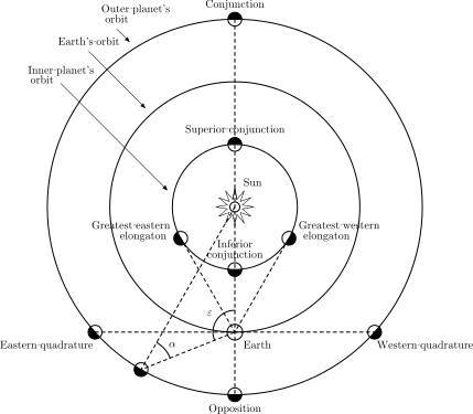

Also, to confirm, in the attached Position_astronomy.jpg image, the circle labeled with “Greatest western elongation” is at quadrature, right? Furthermore, why is it called the greatest WESTERN elongation if it's on the right of the image? Is it because the superior planet is to the left (=west) of the inferior planet?
Another thing I'd like to know is if points E_1 and E_2 in Figure S1.1 are at greatest elongation with the superior planet as a reference point. Are they?
Yet another thing I'd like to know is, in real life, how is one supposed to know that P_2 is at quadrature? Put differently, how is the astronomer (or whatever person) supposed to know when to stop calculating how much time it took for P_1 to go from opposition to quadrature?
I do not see this figure.
I converted what I found on Wikipedia ( http://upload.wikimedia.org/wikipedia/commons/f/f6/Positional_astronomy.svg ) from an svg to jpg and then attached it here. I don't know why you can't see it but, hopefully, the Wikipedia link should work out.
I don't know why
I couldn't/didh't see it either. I can see it now.

First of all, positions P1 and E1 are irrelevant regarding greatest elongation.
If we take the outer circle to represent Earth's orbit and the inner circle to represent the orbit of the inferior planet, then the triangle P2 E2 S corresponds to greatest elongation provided that the triangle is a right triangle with the inferior planet sitting at the vertex of the right angle.
If you were to observe this situation from the inferior planet, then you might say that Earth was at quadrature.​

This discussion began with the rather confusing situation of using one figure (image) to describe two quite different procedures for calculating the orbital radii of the planets. One procedure for determining the radius of an inferior planet. A different procedure for a superior planet.
For an inferior planet: At the moment that the planet is at greatest elongation, the equation ##\displaystyle \ \cos(\angle PES)=\frac{EP}{ES} \ ## does give the distance of the planet from the Sun, relative to Earth's distance from the Sun. That is valid for that moment in time.
2) Is the inferior planet being at elongation the same thing as the superior planet being at quadrature (except that they're each from a different perspective)?
It is in the following sense. At the moment that the superior planet is at quadrature, an observer on that planet would consider Earth to be at maximum elongation.
3) So, let's say I wanted to draw a diagram/figure for the part of the problem where we aim to get an equation with relative distances of the planets for an inferior planet at greatest elongation (=the first part), do I just erase/delete/remove ##P_1##, ##E_1##, place ##E_2## where ##P_2## is and place ##P_2## where ##E_2## is in Figure S1.1 and that's it?
That will work. The equation then becomes ##\displaystyle \ \cos(\angle P_2E_2S)=\frac{E_2P_2}{E_2S} \ ##

As we have established the geometry for an inferior planet at maximum elongation is the same as for a superior planet at quadrature, provided that you switch the labels properly. The helpful aspect of this configuration is that the Sun, the planet, and Earth are each at a vertex of a right triangle.
In the case of an inferior planet: One of the acute angles is formed at the Earth. This angle can be observed fairly directly. Basic trigonometry then yields the relative distances of interest.
You could observe the inferior planet for other configurations, but you would need to combine information from more than one observation/configuration as well as information regarding sidereal periods.
The case of an superior planet is different: In this case Earth sits at the vertex of the right angle of the right triangle. To measure one of the acute angles directly, would require measuring the acute angle from either the location of the planet, or the location of the Sun. To determine the acute angle at the vertex occupied by by the planet, at the time of quadrature, you need to use the sidereal periods of Earth and the planet and use the time between opposition and quadrature. And, perhaps to finally answer your question: Using the acute angle thus determined, does give the relative distances at the moment of quadrature (as in a "snapshot") provided that the planet and Earth have circular (or nearly circular) orbits.​

Sorry for still not getting it but, I'm still not understanding why one cannot answer this differently.
Can't someone just observe the celestial bodies in a different geometric configuration such as one where the bodies are located at vertices of a hypothetical non-right-angled triangle and find relative distances using the law of sines, for example?
Looking back at the OP, the available observations are rather limited. We're talking about data available to Copernicus .
If you're asking, if it's possible to determine relative distances for situations other than those corresponding to right triangles, I suppose it is. The problem is: how do you determine those angles using observations made purely from Earth?
For instance: Suppose we send an observer to Mars, and have that observer determine the angle between the line of sight to Earth and the line of sight to the Sun and simultaneously have an observer on Earth determine the angle between the line of sight to Mars and the line of sight to the Sun . Then we would not need to use a right triangle configuration. However, I suppose if we were able to send an observer to Mars, we would know with great precision, the actual distances involved.
Take a look at the PotentialBetterWay.jpg attachment. (The logic in the PotentialBetterWay.jpg assumes that there is only an observer on Earth - wherever Earth is located.) Could that have been done by Copernicus in addition to what the solution in the book says? If so, is it a better solution than what the book shows, in your opinion?
[Also, if the PotentialBetterWay.jpg is correct and could have been done by Copernicus, that would imply that there was more than one way that Copernicus could have solved this problem despite the solution of the book (understandably) only giving one method of solving the problem.]
If there is something wrong with my logic in the PotentialBetterWay.jpg attachment, please point out what it is.
The observations required for for your PotentialBetterWay.jpg certainly could have been made by someone at the time of Copernicus. The method should work as well as the methods used in the solutions given in your book.
Looking back at the original question: The main information available to Copernicus would likely not include the observations needed for your PotentialBetterWay.jpg . The information available would likely be: synodic periods, times at which superior planets were at opposition, conjunction, and either quadrature, times at which inferior planets were at either conjunction or at greatest elongation and the measure of the greatest elongation.
Any sidereal periods would have to be calculated by Copernicus, using something like the Eq. 1.1 mentioned in your first figure.In reviewing the posts in this thread, I did notice an inconsistency. The problem asks you to find "the relative distances of each of the planets from the Sun". The solution they give for an inferior planet gives ## \displaystyle \ \cos(\angle PES)=\frac{EP}{ES} \,, \ ## which is the distance the planet is from Earth relative to Earth's distance from the Sun. To get the relative distance of an inferior planet from the Sun, one would need to combine this result with the Pythagorean Theorem, or use the sine in place of the cosine : ## \displaystyle \ \sin(\angle PES)=\frac{PS}{ES} \ . ##
You told me what was available to Copernicus but, what about my PotentialBetterWay.jpg file was NOT available to Copernicus, specifically?
Are you saying sidereal periods were not available to him? If so, that would imply that we are defining "available to Copernicus" differently. To me, "available to Copernicus" means information that he is given directly and indirectly where indirectly-given information is information that he derives through calculations, etc.
So, if you are indeed saying that sidereal periods were not available to him, wouldn't that then mean, by my logic, that Copernicus could have done what my PotentialBetterWay.jpg file shows?
In reviewing the posts in this thread, I did notice an inconsistency. The problem asks you to find "the relative distances of each of the planets from the Sun". The solution they give for an inferior planet gives cos(∠PES)=EP/ES, which is the distance the planet is from Earth relative to Earth's distance from the Sun. To get the relative distance of an inferior planet from the Sun, one would need to combine this result with the Pythagorean Theorem, or use the sine in place of the cosine : sin(∠PES)=PSES .
Thanks for pointing that out to me. :)
s3a said:
You told me what was available to Copernicus ...
It seems to me that to derive a formula for converting synodic periods to sidereal periods would require the use of a heliocentric model. Therefore, I doubt that sidereal periods for the planets were available to Copernicus. He would have had to develop such a formula based on a heliocentric model of the Solar System.
Based on the instructions for your exercise,
... information available to Copernicus (observable angles between the planets and the Sun, orbital configurations, and synodic periods)
It seems to me that the methods described in your "PotentialBetterWay.jpg" file could be used.
I'm not sure if I misunderstood what was said but, my interpretation of your answers seems contradictory.
To "freshen the conversation", we know that (1) the solution in the book uses sidereal periods (which would not make sense without acknowledging the existence of the heliocentric model), (2) Copernicus was the one who created the heliocentric model ( http://en.wikipedia.org/wiki/Copernican_heliocentrism ), (3) my PotentialBetterWay.jpg requires, at least, the heliocentric model in order to use sidereal periods so, finally, like you had said at the end of your previous post, he actually could have done it the way shown in my PotentialBetterWay.jpg, right?
I think I have come to the realization that "my way" is, in fact, not a better way (but, it is still a correct way) of solving this problem if we assume the orbits to be fully/perfectly circular because, to think of this problem from a slightly different perspective, we are essentially being asked to find a relationship between the radii of the orbits of the two planets around the Sun (assuming that the book's solution made a mistake when it said part of the answer was cos(∠PES) = EP/ES instead of sin(∠PES) = PS/ES, assuming that Figure S1.1 had no E_1 and P_1 and that it had E where P_2 currently lies and P where E_2 currently lies - also, based on the way the question was phrased and other "traditional academic" stuff I found online, I'm pretty sure this is the case). If we were thinking about ellipses, the law-of-sines (or law-of-cosines) way would actually be better, assuming the angles could be accurately determined (which they can) since it would give the "instantaneous radius" but, given the largely-but-not-fully realistic, close-to-circular elliptical motion, we can assume theoretical perfectly-circular motion in which case, the radii remain the same at all times so it is far better to just use a right-angled triangle in the quadrature/greatest elongation geometric configuration. That and, Copernicus didn't know that the orbits were elliptical at all (and the question doesn't even want us to consider Kepler's accomplishments). It was Kepler that discovered that the orbits were elliptical at some amount of time after Copernicus died, right? Another noteworthy statement is that, assuming perfectly circular orbits, it would always be at least (or, usually, be exactly) two of the three sides of the triangle that would be equal to each other, when comparing "my way" with the "right-angled-triangle way".
Sorry for the long post and for being repetitive but, given that I felt certain statements were contradicting each other, I wanted to clarify the situation. I think I now have a very good handle on this question but, I just need a final confirmation (assuming I do, in fact, understand it correctly).
Is everything I said in this latest post correct?
