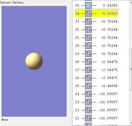

Thank you for your reply! take Cd example, I calculate the atomic orbital with Gaussian! there are 24 energy level,but I don't know which energy level is 3s, which is 4d and so on! would you please to help! Thank you!

Have you tried to read the generated logfiles? Those may contain information regarding orbitals and energy.
