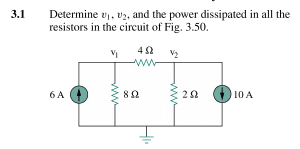

Find v1 and v2 from the given picture.
Ohm's law, V=IR
Current Division
I tried to use current division. The 6A source split into 2, giving 2A down the 8 ohm resistor and 4 amperes down the 4 ohm resistor. Since 10A goes out of the second node, 6A must come up from the ground.
I know one equation would be (V2-V1) = 16. I just can't seem to find the other equation. =/
Try Kirchhoff's circuit laws
You have three loop.
Besides, 8 Ohm:(4+2) Ohm
do you have the answers
I got v1 = 4.2 A & v2 = 16.8
and voltage = 33.6
I want to know if I did it right or not
