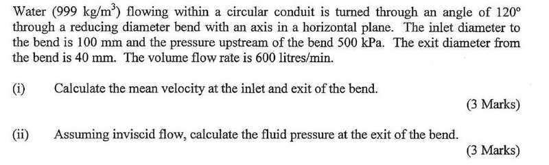

Hey, recently I started revising fluid mechanics and just going some basic problems. Here I need some help with part (ii)
Well I've calculated the inlet and outlet velocities, converted all units to their appropriate values in meters, seconds and pascals etc.
I know that pressure is force per unit area, and thus can obviously calculate it for the inlet of the bend. But how does this relate to the outlet pressure of the bend? How do I calculate that?
Thanks in advance everyone.
You don't need to use P=F/A. Pressure at the inlet is given.
You should use Bernoulli's equation to find the pressure at the outlet. Since velocities are needed in Bernoulli's, you have to calculate the inlet and outlet velocities. These can be calculated since you know the inlet and outlet areas, as well as the volumetric flow rate.
