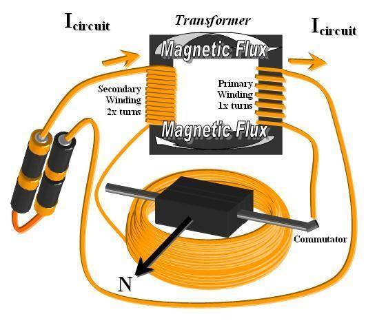

What happens if you connect the following in this order:
1) from a battery to the primary in
2) from the primary out to the secondary in
3) from the secondary out to a motor
4) from the motor to the battery
I know that transformers usually step up or step down the voltage, but it shouldn't be possible to feed a stepped up voltage and add it to the total voltage right? So what would REALLY happen?
Say if it was a step up transformer, the voltage would go up and the current would go down. But in my example, the current that goes through the primary windings would also go through the secondary windings. This complicates things I know, but does anyone have a good answer as to what would happen? Thanks.
I believe you've just made your transformer a very long piece of wire.

Can you provide a sketch of what you're doing?
TVP45 said:
I think the meaning of the phrase is that it is a line transformer which is meant to be driven at a constant voltage. Once long ago, when the world was still young, I used those to drive horn speakers at public events.
The commutator will certainly help, but you will have to watch the frequency. Remember that the back end of a square wave is about 0.1 the fundamental frequency.
The idea of adding windings in addition or subtraction certainly works ("buck-boost" line transformers do this all the time), but you're always stuck with a power output that is less than the power input (somewhere between maybe 80% and 99%).
I think the point that might be throwing you off is the idea that it is current that causes the magnetic flux in a transformer core. In fact, as noted earlier by others, you should look at a transformer in terms of the flux being proportional to the changing voltage. There are typically three currents then that you see: a magnetizing current; a losses current; and a load current. The load current, which is what flows through your motor, is pretty much irrelevant to the core (or at least should be).
Here you go.
kmarinas86 said:
Here you go.
Ok, thanks. What you have shows that the current through the transformer more or less stays constant (never reverses). The core will saturate and effectively "disappear". So, as somebody pointed out, you now have a long wire. A transformer is really only useful as an impedance matching device, that is, it trades voltage for current or vice-versa. It never gives you more power.
Not sure about the reversing. The commutator open and closes the pathway as the rotor rotates. So I would expect the current signal to be somewhat of a square wave. The current is obviously not going to be constant as a function of time, but only constant as a function of distance through the wire, I believe, and that's what matters as far as the change of magnetic flux through the different windings are concerned.
Although the amplitude of the square wave would be limited by a maximum (depending on the current source), the rate change of magnetic flux in transformer windings will change with the acceleration and deceleration of current each time the connection is made. The waves are complicated however; if the peak acceleration of the current occurs after a small fraction of the total charge for that connection has passed through, the speed of the rotor (i.e. the reduction of connection times) may have little to do with the peak acceleration of current that leads to the greatest rate change of magnetic flux. However, if the connection is cut off before the current can accelerate to its maximum, then the effective rate change of magnetic flux (voltage produced) is not as high.
I guess only experiment will show what exactly happens. Sending 1 amp in and out of the secondary winding when transformer is rated at 70 volts and four watts may have some weird results, especially when the current spike passes through the primary windings affecting the current behind it in some way. These feedback effects, I believe would have an effect on the distribution of charges, but not so much the current passing through the large coil. Since mass flow rate = velocity of masses * linear density of masses, I would expect similar things for charges.
The current is obviously not going to be constant as a function of time, but only constant as a function of distance through the wire, and that's what matters as far as the change of magnetic flux through the windings are concerned.
'Tis the voltage, Katie Scarlett, 'tis the voltage.
