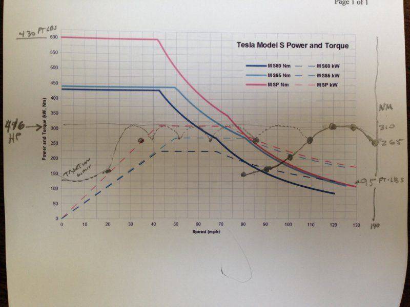

Peak torque for an electric motor occurs at 0 rpm and decreases linearly until it become zero torque at max rpm. Internal combustion engines produce peak torque at some rpm, but with an ideal CVT (continously variable transmission), peak torque delivered to the rear wheels occurs at the rpm corresponding to peak power.

I just wanted to add that the Tesla Model S Performance goes 0-60 in 4.2 seconds.
Is the heaviness of lithium ion batteries what's slowing down electric cars? I mean, electric motors are superior to IC engines, right?
  • #35
"superior" is a subjective term.
f=ma
which yields: a=f/m
therefore, with two vehicles with similar motive forces, the one with the smaller mass will have a higher acceleration value.
Tesla S:
Curb weight: 4,647.3 lbs
torque 430 Nm​
Porsche 911 S Turbo:
Curb weight: 3680 lb.
torque 710 Nm​
Given that the Porsche has both higher torque and weighs less, it's a no brainer that it's faster.
