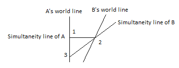

If B is moving away from A, then B's simultaneity line through the event where he receives the original message, may intersect A's world line at an event earlier than the one where the original message was sent. This makes it conceivable that the reply message (if it's near instantaneous in B's rest frame) reaches A before the original message was sent.

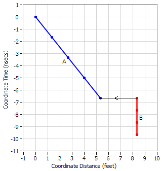

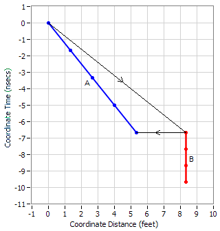

If you want to see the scenario described in more detail, see posts 133 and 134 here: https://www.physicsforums.com/showthread.php?p=2588832. Post 133 is a description of a scenario with infinite-speed messages (infinite speed in the sender's rest frame). I'm afraid I was too lazy to draw a diagram. Post 134 has a link to a spacetime diagram for a scenario with finite-speed FTL messages.

An FTL message that's just reflected and returns with the same speed (in Earth's rest frame) just arrives less than 170 minutes (or whatever) after the message was sent.
To see anything funny in a thought experiment, the recipient of the original message has to be moving away from the sender at close to the speed of light, and it's essential that the reply he's sending is a very fast FTL message in his rest frame. (You need to look at a spacetime diagram to see why this leads to weirdness).

A communication that take no time at all would have to move as described by a horizontal line in a spacetime diagram (so that both endpoints will have the same time coordinate). Light moves as described by a line drawn at a 45° angle.
verty said:
Regarding this, suppose Saturn's rings are sufficiently reflective for us to use them as a mirror. We send some photons toward them at the speed of light, they return and we detect them. There will be a time delay, ~170 minutes (sorry, this is not the correct delay, it'll be somewhat shorter). So there is a window of maybe 2 hours for faster communications to return. Does SR imply that no communication of any hypothetical speed can arrive in this time window? It seems odd to say that faster communications could in fact arrive in negative time (violating causality) but not in this window.
With hypothetical faster-than-light signals, a return signal could arrive anywhere in this timeframe, that would be no problem. But that is the boring part of FTL - the more interesting part is the possibility to get the answer before we even send the message out.
With SR as we know it, you can have either causality or FTL signals, but not both.
That depends on the (completely unknown) way to send those signals. Sure, all the scenarios consider faster-than-light signals that still move forward in time in the frame of the emitter - but why should this be the limit? We know for sure that you do not need a large spacecraft moving away: a small emitter inside (maybe even a single atom), moving away for a short period of time, could be sufficient in this hypothetical scenario. Maybe this emitter can even do the same without moving - directly sending messages that travel backwards in time in the frame of the emitter. Sure, it violates causality, but that's what all those scenarios are doing.

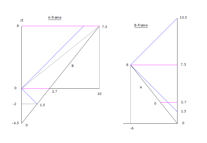

A signal faster than light requires less time than one at light speed, but it is not instantaneous or zero. A finite amount of time ocurrs between emission and reception. Your assumption (red) is incorrect.
The simultaneity axis for B is a calculation convention, in effect for the local observer B.
B’s motion does not affect the clock rate of A. The A clock still runs forward, accumulating ‘time’.
It's not wrong, just poorly explained. He just failed to mention that the original FTL message is near instantaneous in A's rest frame, that the reply is near instantaneous in B's rest frame, that B is moving away from A at close to the speed of light, and that B is already far from A.

I made my own diagrams to illustrate a similar scenario. First we start with the rest frame of A who sends an instantaneous signal to B at the Coordinate Time of zero:
Then we switch to the rest frame of B who sends an instantaneous signal back to A at the Coordinate Time of -6.67 nanoseconds:
A receives this signal at his Proper Time of -4 nanoseconds as indicated by the dots or as indicated in his rest frame by the Coordinate Time:
But as we can also see in the above diagram, the return signal is traveling backwards in time in A's rest frame so it's no wonder it arrives before A sent his signal. And in B's rest frame, the first signal goes backwards in time so it's no wonder the return signal arrives before the first signal was sent:
And as long as we're going to permit signals changing their speeds in different frames, why do we need B to be traveling at a relativistic speed? Why can't he just be stationary in A's rest frame and merely reflect the signal back to A like this?

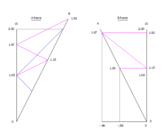

In drawing ftl2 the ftl signal moves at 2c. B moves at .5c, with c=1
Using the SR synch convention (radar or pinging method), the emission event A(x,t)=(0,1) is assigned to B(x,t)=(-.58,1.15),
and the detection event A(x,t)=(0,1.67) is assigned to B(x,t)=(-.96,1.92).
B calculates the incoming signal as instantaneous,
and the outgoing signal at .96/(1.92-1.15)=1.25.

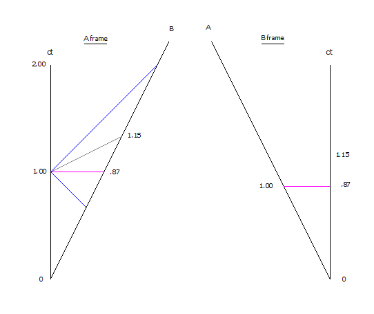

In drawing ftl3 the ftl signal is instantaneous. B moves at .5c, with c=1
Since the time of travel is zero, and equivalent to zero distance, emission, reflection, and detection events are simultaneous and coincident for A. Thus must be coincident for all frames.
There could be any number of cycles relative to A in zero time. No information can be obtained in zero time. The same radar method does not work for this case because it requires a finite amount of time.
This is the view of universal time, before SR, i.e. observers see events in real time(as it happens).
