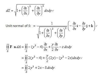

2)
Am I right so far? If so, I am stuck now, I don't know how to write this as an iterated integral...restrictions are on y and z, but I have dxdy. This is weird...what is going on?
Another thing, did I get the correct normal that points away from the z-axis? How can I confirm this?
Thanks!
kingwinner said:
2)
Thanks!
You are missing the limits on the x-coordinate which you need since you are integrating, as you say, with "dxdy". The equation is z= y2- x and z can range from 0 to 4. If z= 0, then 0= y2- x so x= y2. If z= 4, then 4= y2- x so x= y2- 4. You integral should be
[tex]\int_{y= -2}^2\int_{x= y^2- 4}^y^2 dx dy[/itex]

2) (i) If z=0, x= y2. If z= 4, x= y2- 4. But in general is it possible that at e.g. z=1.8, that x is NOT between y2- 4 and y2, i.e. it goes OUTSIDE of it?
(ii) z = y2 - 2x and restrictions are on y and z. If I solve for x in terms of y and z at the very beginning, then I would have all constant limits of integration, am I right? Will this method work as well?
(iii) In general, for this type of question, do I even need a UNIT normal? or is it the case that ANY normal pointing in the right direction would work? I am very confused about this idea...
I thought we'd dealt with that before.
In many books they give the formula as [itex]\int \vec{f}\cdot\vec{n}dS[/itex] where [itex]\vec{n}[/itex] is the unit vector to the surface. Of course, calcuating that requires calculating a normal vector to the surface. The simplest way to do that is to write the "position vector" of a given point on the surface as [itex]\vec{r}(u,v)= x(u,v)\vec{i}+ y(u,v)\vec{j}+ z(u,v)\vec{k}[/itex] in terms of the parameters u and v (if the surface is given as z= f(x,y), we can use x and y as parameters: [itex]\vec{r}(x,y)= x\vec{i}+ y\vec{j}+ f(x,y)\vec{k}[/itex]). (That's often called the "fundamental vector product for the surface".) Then the derivative vectors, [itex]\vec{r}_u[/itex] and [itex]\vec{r}_v[/itex] line in the tangent plane to the surface and so their cross product is normal to the surface: call that [itex]\vec{N}[/itex]. The unit normal vector is given by [itex]\vec{N}/||\vec{N}||[/itex]. But it is also true that the differential of surface area is given by ||\vec{N}||dudv. Of course, it makes no sense to calculate the length of that normal vector because the two lengths will cancel.
I prefer to talk about the "vector differential of surface area", [itex]d\vec{S}= \vec{N}dudv[/itex]. Then you can write [itex]\int \vec{f}\cdot d\vec{S}[/itex] and only have to calculate [itex]d\vec{S}= \vec{N}dudv[/itex]. However, you can't use just any normal vector- it has to be specifically the "fundamental vector product", the crossproduct [itex]\vec{r}_u\times\vec{r}_v[/itex].

There is still something that I don't understand...
e.g. Say, a surface is given by F(x,y,z)=0
Then grad F is a normal N to the surface.
e.g. Say, a surface is given by x+2y-4z=0 (plane)
Then (1,2,-4) is a normal N to the surface
So to get the unit normal n appearing in
I can just put n=N/||N||
But what does dS become in these 2 cases?
My textbook always says that dS=||Gu x Gv||dudv where G is some parametrization of the surface, then is it also true that
dS=||grad F||dxdy
and dS=||N||dxdy where N is any normal (not necessarily equal to Gu x Gv)
Or does it always have to be the case that dS=||Gu x Gv||dudv? If so, then the norms/lengths cannot cancel in the two cases I mentioned above...
Please help as I am totally confused on these concepts and I am not able to find answers to these in my textbook...Your help is greatly appreciated!

What is F here? If z= F(x,y) then ||grad F||= [itex]\sqrt{F_x^2+F_y^2}[/itex] but dS= [itex]\sqrt{1+ F_x^2+ F_y^2}[/itex]. Or is the surface given by F(x,y,z)= constant? And why would [itex]\nabla F[/itex] work specifically for a projection onto the xy plane? What is you projected onto the yz plane instead?
What you can do is take [itex]\nabla F[/itex] and "normalize" to the xy plane by dividing by the z-component. For example, if [itex]z^2= x^2+ y^2[/itex] (the cone), Then we can write F(x,y,z)= x^2+ y^2- z^2= 0. Now [itex]\nabla F= 2x\vec{i}+ 2y\vec{j}-2z\vec{k}[/itex]. Dividing that vector by the [itex]\vec{k}[/itex] component gives [itex]-(x/z)\vec{i}- {y/z}\vec{j}+ \vec{k}[/itex] and its length is [itex]\sqrt{(x^2/z^2)+ (y^2/z^2)+ 1}= \sqrt{(x^2+ y^2+ z^2)/z^2}[/itex]
[itex]= \sqrt{2(x^2+ y^2)/(x^2+ y^2+ z^2}=\sqrt{2}[/itex] and dS= [itex]\sqrt{2}dxdy[/itex] as we should have.
It should be obvious that this can't be true. If N is a normal, 2N is also but ||2N||dx= 2||N||dxdy. You must have misunderstood your textbook.
There may be different ways to calculate it, but the "differential of surace area" is a specific number times dxdy, not just "any number"dx dy which it would be if you could use a normal vector with any length!
