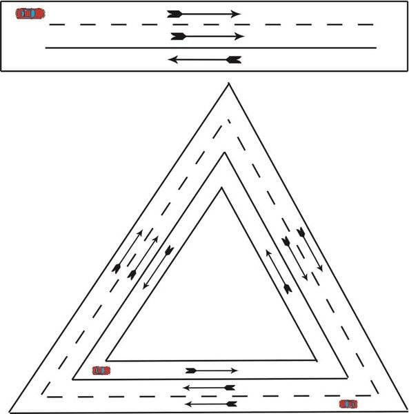

I repeat myself. What is wrong with the algorithm below:
Suppose that we are in an inertial frame. Then consider the triangle ABC.
a) Synchronise A and B with the Einstein method.
b) Synchronise A and C with the Einstein method.
c) Measure the light speed that travels from B to C.
d) Measure the light speed that travels from C to B.
The Einstein synchronisation implemented in "a" and 'b" does not guarantee that the results of "c" and "d" coincide to each other. This means measuring the one-way speed of light in my eyes.
Opps, I edited my post while you added your last post, but I answered your question in my previous post.
You need to edit your post again to be consistent since you have added "d" where I think you mean "b".
I mean "d"
ghwellsjr said:
If we synchronize clocks A and B and we also synchronize clocks A and C, then we know that clocks B and C will also be synchronized.
I disagree with this point. If one-way light speed is anisotropic, synchronisation of A and C, and synchronisation of B and C does not necessarily imply synchronisation of A and B.
As a simplified example: Please draw a triangle. Assume a clockwise speed and an anti-clockwise one for light on the edge of the triangle. The light pulse that travels clockwise shall go faster or slower than the one on the anti-clockwise direction. This difference is independent of how you synchronise your watches on this special case placed on the corner of the triangle. This difference is a physical quantity, while you are arguing it is not.

It does guarantee it, at least if the two-way speed is still c. Try coming up with an example and doing the math, you'll see (for example, suppose that in your chosen coordinate system, light has a speed of c+v in one direction and c-v in the opposite direction)

Very true but Einstein defined light speed to be isotropic not anisotropic. If you want to define light speed to be anisotropic, then why do you care about Einstein's clock synchronization method?
Are you suggesting a three-segment speed of light test in which we have two mirrors and one source/detector? First you aim the light at one mirror which reflects it over to the second mirror which then reflects it back to the source/detector and measure the time it takes for the pulse to get around back to the source/detector and then you repeat with the light aimed at the other mirror so that the light travels the same path in the reverse direction? Are you saying that if you perform this experiment you will get two different answers for the time it takes for the light to go around the triangle in the two different directions? If I understand your experiment correctly, why do you need to synchronize any watches when you can do the whole experiment with just one watch located at the source/detector of the light? Please clarify.

Consider a triangle wherein the light speed in not the same for clockwise direction and anticlockwise one. In this example, the two-way speed of light is isotropic but it is the one-way speed which is not isotropic.
elisir said:
I would highly appreciate it if you first would possibly put your "assurance" on a test on the simplified case I described above, repeated below:
You're right, I was thinking of the type of anisotropic speed that results from doing a non-Lorentzian coordinate transformation on an inertial frame where the speed of light is isotropic (an example would be the Mansouri-Sexl transformation), but more generally it would be possible to have a theory where there is no frame in which the speed of light is isotropic.
An issue here is that if you have a theory with an anisotropic speed of light that isn't physically equivalent to SR (i.e. you can't do a coordinate transformation to get an SR inertial frame where the speed of light is isotropic), then even if you have one frame where observers at rest in that frame will measure the two-way speed to be c, I have my doubts that it'd be possible to have such a theory where observers moving at arbitrary constant velocities in this frame will also measure the two-way speed to be c regardless of which direction they aim the beam. And if there is only one preferred frame where the two-way speed is c, then experiments like the Michelson-Morley experiment should not be expected to show the two-way speed is constant when the experiment is performed at different points in the Earth's orbit.
That sounds like a test of rotation, not anisotropy. I.e. the Sagnac effect. You are correct that the Einstein synchronization is not transitive in a rotating reference frame.

I agree that it can be used to test rotation too. But in this set-up, we do not need to keep something rotating. We just display the triangle a bit. Make it at rest with an inertial frame and perform the measurement. This is somehow similar to Sagnac effect, but it is not this effect.
Can you demonstrate mathematically what the difference is? It sounds exactly the same to me.
Also, the triangle cannot be at rest in an inertial reference frame since an inertial reference frame by definition is one in which the one-way speed of light is isotropic and equal to c. So you are by definition considering non-inertial reference frames. From your description it sounds like the specific non-inertial reference frame you are considering is a rotating reference frame (i.e. same metric as a rotating frame).
The mathematical framework for the triangular system is that of Trimmer experiment, extended to resonators in section II of

Imagine that streets have an upper speed limit and this speed limit is the light speed.
Imagine that you have a car that could instantly reach the speed of light.
Imagine that you don't want to get any speed ticket, but you will derive as fast as possible.
Imagine that streets are not symmetric. They do not have the same upper speed limit in opposite direction.
Now the one-million dollar question is that, can anyone measure the one-way speed limit by just looking at where and when you start deriving and when and where you stop?
Now look at this picture:
This is the situation I described by words above.
If you derive in one direction and come back on the same path, reach to the point you started deriving from and tell us how much time your journey takes, we can not deduce the one-way upper speed in your path.
If you derive in a triangle, and tell us whether you rotated clockwise or anticlockwise, we can measure the one-way upper speed limit. Look at the picture, rotating clockwise takes less time or anticlockwise direction? the answer is clear.
Only in the case that you don't come back to the point that you started deriving from, we need clock synchronisation. So, please derive back to the point you started deriving from. This is the point that you break what you call the circle of time and synchronisation. Once you reach to the point you started from, we do not need synchronisation.

  • #33
Your pictures are the same ones from the link you provided in which you said that you only provided the link to answer DaleSpam's request for a mathematical demonstration of the Trimmer experiment. I didn't think you were promoting this new proposed experiment.
When I looked at the paper and saw the diagrams with the cars on the streets and read the explanation, it made absolutely no sense to me but I didn't ask for an explanation because you didn't indicate you were putting any confidence in this proposed new experiment but now it appears that you are. But, your explanation makes no sense. I have questions:
Why are there two lanes going one way but only one lane going the other way?
Why is there only one car shown in the top graphic but two cars shown in the bottom graphic?
Is there any significance to the fact that the two-lane direction is outside the one-lane direction in the triangle and therefore a longer distance?
Are these graphics applicable to the Trimmer experiment or only to the new proposed experiment?
Isn't it the case that in the Trimmer experiment and the new proposed experiment, the light traverses exactly the same path in the two directions?
Why doesn't the graphic show something equivalent to the piece of glass or other optical device that is present in the real experiments?
But to answer your million dollar question: of course, we super-beings looking down on this graphic could measure the one way speed of the cars because we have super clocks and super rulers that allow us to determine the real graphic distances and times. But graphic-beings can't "see" ahead to know when the car reaches the other end of the track.
That is our problem when we try to measure the one-way speed of light. Once the light leaves our source, we have no idea where it "really" is until something (a detector or mirror) a known distance away communicates back to us that it has arrived at that point and then it takes time to communicate that information back to us so unless we make some assumptions about how long it takes for the communication of that information back to us, we cannot determine absolutely when the light reached our detector or mirror.
How does your graphic (or the Trimmer experiment or the new proposed experiment) solve this problem?
