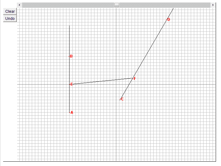

Attached are three spacetime diagrams. Worldline A-B is Albert and C-D is Cindy. Albert is evil so at event 'E' he shoots Cindy with a tachyon gun, the particles travel at 10c. Cindy is grazed on the forearm at event 'F'.

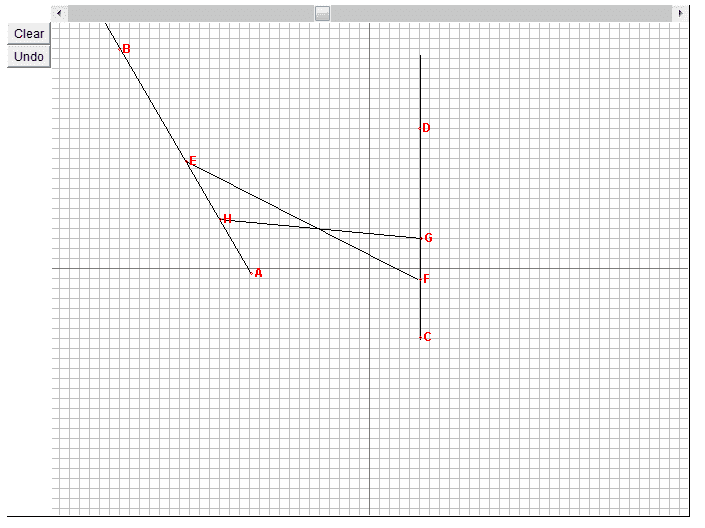

The second diagram shows those events from Cindy's frame, note that Albert's shot seems to travel backwards in time from her perspective. She picks up her tachyon gun at event 'G' and shoots back. The particles again travel at 10c hitting Albert at event 'H'. Cindy is the better shot and Albert drops dead, just before picking up his gun and firing at Cindy. His posthumous view of the whole exchange is shown in the third diagram.
The moral is don't play with tachyon guns or you might find you've been a zombie!

Hrmmm. I don't understand what the graphs represent very well. What are they called and where can I find out more on them?
Do they represent the sequence of events as perceived by each person? IE does graph number 2 represent the frame of Cindy and show what she sees, which is of course limited by light speed?
Is this paradoxical effect simply because the graph is set to have c as the limit?

If you mean the ones in my post, they are just standard spacetime diagrams. The applet linked in the post let's you draw worldlines and events then the slider at the top controls the velocity of the observing frame. The java implements the Lorentz Transforms. I just used it to draw a simple demonstration of the equivalence of FTL and a time-like loop, the text explains what is shown. Basically it is just the grandfather paradox with a different storyline. The OP in message #5 said "I prefer using space-time diagram to discribe this kind of situation." so that's what I did.

They are called "spacetime diagrams" and yes, basically graph 2 is how things look in Cindy's rest frame. The diagrams conventionally have space (distance) along the horizontal axis and time along the vertical axis. Try out the applet posted by George http://www.reagenix.com/personal/sci/space_time/test.html. If you draw a line at 45 degrees to the vertical representing the null worldline of a photon and move the slider you will notice that the line remains at 45 degrees for all observers demonstrating the constancy of the speed of light for all observers.
Also note that in graph 2 produced by George, it can be interpreted that Cindy fired two tachyon shots at evil Alex and Alex looks like the innocent victim of an unprovoked (double) attack by Cindy. Once we accept that FTL interactions, then notions of what was the cause and what was the effect no longer make any sense. Cindy's claim that she was acting in self defence and that Alex fired the first shot, looks pretty week because Alex was dead before he made the alleged initial attack. The prosecution claim that Cindy fired the first shot instantly killing poor Alex and then fired another shot into his dead body for good measure. We also have the problem of defining histories in a universe that allows FTL interactions. For example, was Alex alive or dead between events E and H?
Looking at events E and F, although F seems to happen "first", it is the burn on Cindy's arm produced by the firing of the gun at E by the remains of Alex, so the effect precedes the cause.
Of course that's the point, the gun was fired by the corpse unless we insist that the timelike loop must be self-consistent.

Well it is not clear that Cindy's arm would be burnt as we go forward in time again, because Alex, perhaps along with his tachyon gun, has been destroyed so he is not in a position to do anything. In this case it looks like "evil" Alex is killed in a single unprovoked attack by "nice" Cindy.
As mentioned in #18, the first time around the loop, Alex is alive between events E and H and the second time around he is dead between those same two events. This requirement for different histories probably requires the concept of parallel universes to make sense. Can we say FTL interaction not only implies traveling backward in time, but also implies parallel universes?
