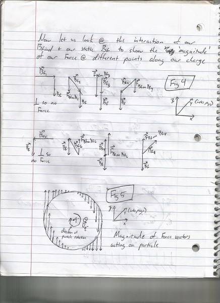

I have been looking at mass spectrometers, in particular the interactions between the Bf ind of a charged particle in motion in a static Bf of the spectrometer.
Figure 1 and 2 shown below are a basic 2 dimensional slice of the problem from the top (fig 1) and from the inside of the radius looking out (fig 2) to establish our F.o.R.
Figure 3 is a view of the charged particle moving towards us at velocity vq- with the 'direction' of the Bf ind shown along 8 symmetrically spaced points.
[URL=[PLAIN]http://s1332.photobucket.com/user/ian5576g/media/crossproductpage1_zps8daf6515.jpg.html][PLAIN]http://i1332.photobucket.com/albums/w606/ian5576g/crossproductpage1_zps8daf6515.jpg
Figure 4 below shows the interaction of the Bf ind with our static Bf along these 8 points and the resultant Force at those points. Figure 5 uses this information to draw a 'representative' magnitude for the Force along different points acting on our moving charged particle in the static Bf. To me this looks like the Force at these points would mediate a rotation about an axis drawn through a charged particle in the direction of 'y' if moving through a static Bf as shown, is this correct?

I was thinking the particle as being a single electron or proton moving through a static Bf. Will they rotate in a mass spectrometer as well?

So this rotation creates only one of two states leading to the discovery that electrons in motion behave like a dipole as shown by a modified Stern-Gerlach Experiment.
I have been drawing this one up but am not seeing how a rotating Ef would create a dipole perpendicular to that of the motion. Should I look at it from the standpoint of the rotating Bf ind of the particle instead?
In the classical image, the charge of the particle is thought of as being distributed in space - much as you drew.
Recall that moving charges are an electric current, and an electric current has an associated B field.
If the charge distribution is rotating, then the charge element a distance r from the axis of rotation is moving in a circle - so it is a current loop - so it is a little electromagnet. Since all the charge elements rotate the same direction, they add up.
You can do the math for a rotating sphere of charge Q and radius R if you like.
But the math doesn't agree with experiment.
The modern description is statistical - via quantum mechanics.
A particle may have a non-zero magnetic moment as if it were spinning - but we do not imagine the particle actually spinning ... more that it "carries" angular momentum with it much as it may carry linear momentum and charge and kinetic energy and so on.
If a particle has angular momentum and charge, then it also has a magnetic dipole moment.
The reason I brought this up is that you have managed to explore a bit of theory where the model you are using is not adequate to the task... so you have just hit the next level. It will feel very strange for a while but you get used to it.
What you have been doing would be appropriate for a classical charged insulator fired through a B field rather than a fundamental particle.

I got past the sticking point from yesterday, nice to see your suggestion is in line with it. The figures above are illustrating a point charge in motion with the Bf ind some distance 'R' from it giving me trouble spotting a dipole induced by a rotation of an electron.
I redrew the problem with a distribution of charge for an electron from the point of view of the surface so that it is easier to see how a rotation will induce a dipole. Unfortunately (as you pointed out here) it seems the Stern Gerlach experiments show that the dipole can only face in one of two possible directions which wouldn't make sense for this type of system.
So QM uses angular momentum but there is no actual rotation? This should be fun although I still have more to explore in classical mechanics before diving into the deep end of the pool. Thanks for the help, I should probably not add any more to this thread as I have already strayed far from the initial topic.
What QM does is tell us that the phenomena that we classically label "angular momentum" may not always be sensibly talked about in terms of the phenomena that we classically label "rotation".
We don't think of an electron, say, as physically spinning any more than we think of an electron in an atom as physically "orbiting" the nucleus like a planet... although we do say it has orbital angular momentum.
It is possible to fire a whole bunch of particles with the same "spin" at a macroscopic object - thus transferring angular momentum to that object, to see if it tries to rotate. And it does.
Maybe this means that the particles are actually" spinning? But how would you tell?
It just doesn't make sense to talk about what a particle is "actually" doing.
But it is exciting to think that you are at a place in your studies now where you are hitting the limits of what conventional knowledge can deal with. Have fun - there's lots to be had :D
