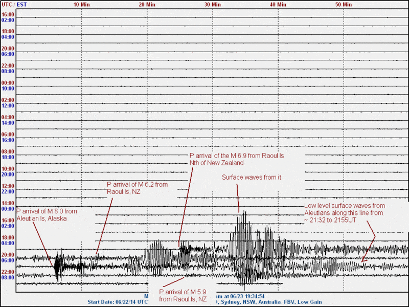

I'll be curious to see if yours sees that Alaska 'quake a couple hours ago...
Yes I recorded it Jim, but because it was quite deep, ~ 108km, it wasn't huge on the seismographs
Deep quakes don't produce much in the way of surface waves
It was totally outclassed by 6.9, 6.3 and 6.2 quakes much closer to me in the 1.5 hours prior to the Aleutian Is M8.0 event
here's a low gain long period channel on my system that shows the different events
http://www.sydneystormcity.com/zlo1.gif
Am at work at the moment ... give me a little time and I will save an image and label the events :)
Dave
OK here we go
you can see on that indicated line that the surface waves from the M 8.0 were minimal
Had this been a shallow quake < 30 km the surface waves would have been almost full amplitude ( top to bottom of the screen) even on this low gain channelEDIT ... some updates ... its been now downgraded to a M 7.9
It produce a local Tsunami of ~ 0.2 - 0.7 ft
This quake was quite a long way back (and deep down slip ) from the trench so hence why it didn't produce any significant tsunami
cheers
Dave
