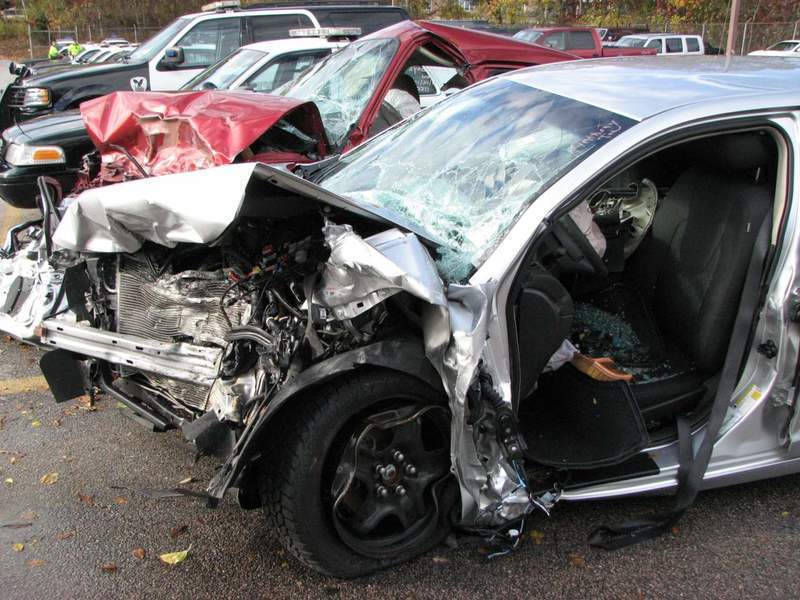

I recently was in a head on collision. I am just a dumb fireman that needs an answer about my survival. I would like to know how many g's I was subjected to in my crash. They checked the event data recorder in my 2011 Ford Fusion and found that I was going 42 mph and in the same instance I went 4 mph backwards. The police said I should not have survived but here I am. I weight 175 lbs. The other car was about 600 pounds more than mine. I was belted in and the air bag did deploy. I am suffering a concussion and although I never lost consciousness I lost about 8 minutes of memory. I just would really appriciate an answer to help me cope. Thanks George
If you need any more info please let me know.

Thanks for the reply. Yes, I was going forward and then 4 mph backwards. You are correct about the crush zone on the car. As you can see from the picture the passenger compartment stayed intact. The police only talked about my survival after a very long investigation. I guess they ran all the numbers,weights,marks in the road, etc. before they gave me that conclusion. I was the driver and I was alone in my vehicle. The other driver crossed the yellow solid line and we collided.I felt awful we both got hurt but there was nothing I could do. My head must have hit the airbag but I did have a cut on my forehead. I actually have gone to many car accidents for my job but I have never been on this side of the situation. Cars are quite remarkable compared to the old days. People were hurt much worse at lower speeds. I did have many aches and pains. I actually had bruises on my body from the seat belts within a very short time. Again thanks for the reply. 20 G's is alot of force.

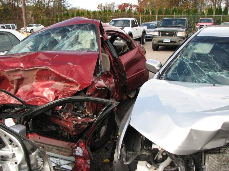

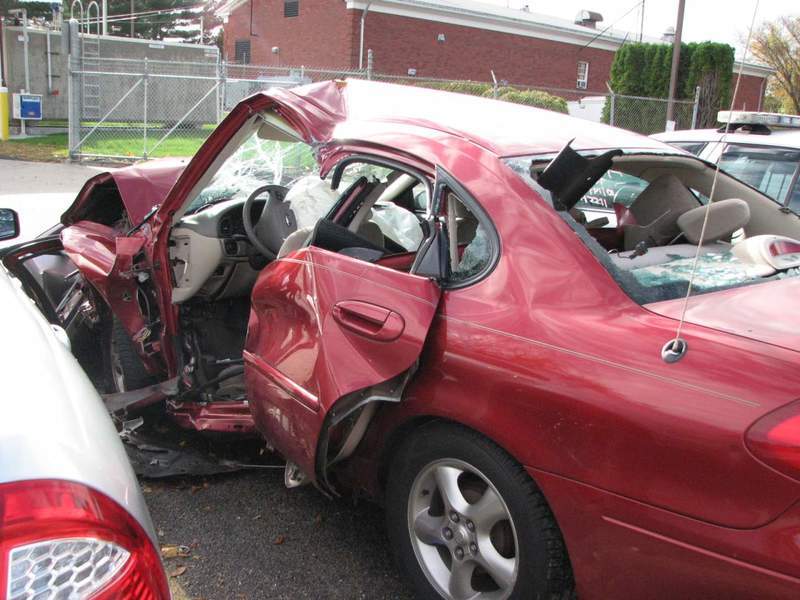

Nov15-12, 07:32 AM   #13
Quote by CWatters View Post
What happened to the other guy ?
This was her car.

Having constructed facilities for crash-test, hence knowing a bit about tests and car design, I can confirm that you've been really lucky to survive, and the other driver even more.
Standards do not require anything from cars crashing at that speed. Some manufacturers try to do their best under these conditions, but consider luck must be with the passengers then. In the favourable symmetrical head-on crash, 40km/s or 50km/s is considered a well-survivable speed.
I attended once a test at 70km/s, and I didn't imagine someone would survive. The car had kept the inhabited room in a survivable shape but I thought people would be killed by the deceleration. As a spectator, you feel it incredibly brutal. Now I know that trying to design cars for that crash speed does make sense.
You can buy again the same car model. The red one isn't bad neither. Possibly, the paths made an angle and the impact was more from the side for the red car.
If I get it properly the collision was head-to-head with a small offset to the right, the vehicles had nearly the same speed, the red one is marginally heavier, and both nearly stopped at the impact.
This supposes that the damage at the red vehicle results from this unique impact. If the read car impacted first at its left and then crashed into an other obstacle, it would change the following.
Admitting that both cars went from 67km/s to 0 within 0.8m, the mean deceleration over 86ms was 22G.
Sitting in a car, surviving 22G is not probable. If laid on the back, 22G is survivable but people are expected to lose consciouness. The emergency rocket from Soyouz was used once and saved the cosmonauts at 20G.
