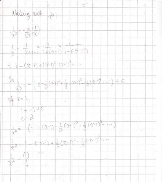

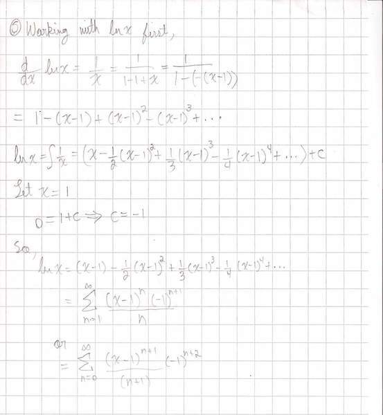

See figure attached.
Okay I think I handled the lnx portion of the function okay(see other figure attached), but I'm having from troubles with the,
[tex]\frac{1}{x^{2}}[/tex]
[tex]\int x^{-2} = \frac{-1}{x} + C[/tex]
How do I deal with the C?

You're going about it backwards. Use
[tex]\frac{1}{x^2} = -\frac{d}{dx}\left(\frac{1}{x}\right)[/tex]

Alrighty I think I've got a series for,
See figure attached. Is this correct?
I can't seem to figure out how to express it sigma notation however.
Any ideas?

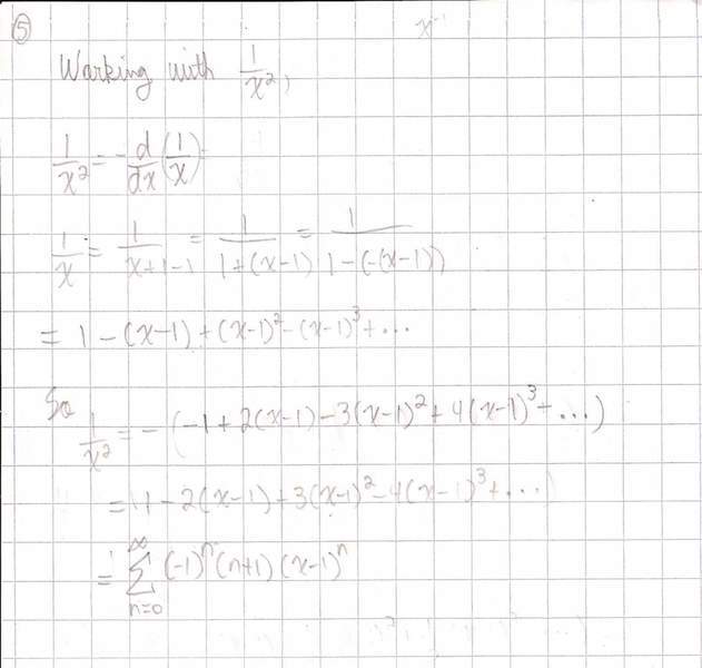

No, it looks like you integrated the series, but you want to differentiate -1/x to get 1/x2.
Whoops!
How does this look? (See figure attached)
Looks good!
