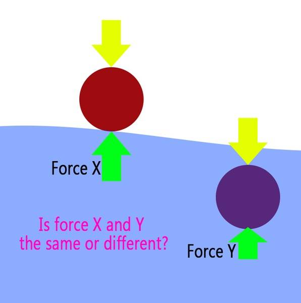

What is the difference in force between the first impact and water resistance?

I really want to know if there is a difference between the force from the first impact of water and the force from water resistance. If it is different can someone tell me a explanation on why it is different?
Example:
I am not quite good at physics and would like some help
Thanks!
The force at first contact, the way you drew it with just a tiny contact area, is tiny. The pressure (force / area) can be high though.
So yes, the forces are different, because the submerged ball interacts with more water, and therefore transfers more momentum to it. But when the submerged ball slows down the force goes down again.
So if it is a cube instead of a sphere, will the resistance force be the same as the force at first contact if the velocity is exactly the same for the 2 objects?
I'm not sure what you mean by resistance force, nor how you would judge different vs. the same.
One significant event during this time is the rapid, non-uniform, deceleration that the object experiences entering the water. While the part of the body under water is in highest deceleration, the rest of the body above the water is still in full acceleration. In your diagram, if case X is meant to show a cube that has already contacted the water and has begun deceleration, the internal stress forces on the object will be different than case Y. That's because in case X, the part under water is moving slower than top, and that's a big deal.

Okay, and thank you. However, What do you mean by your last sentence, "That's because in case X, the part under water is moving slower than top, and that's a big deal."
The entire cube is accelerating until it begins entering the water. When the 'front' (bottom) contacts the water, everything above the water continues acceleration while the front part entering the water begins rapidly decelerating. The quickest that the rear end can 'learn' and react to what's happening at the front is limited to the speed of sound within whatever the cube is made of. The rear end continues to try to react albeit with this short delay until the cube is entirely submerged. It's because of this process that significant internal stress occurs due to compression while the object is partially submerged.

They are different because when the object impacts the surface it is finding out that there is something there and is governed by shock hugoniot equations with a pressure that looks like rho*soundspeed*velocity. For subsonic velocities, the pressure while in the fluid is going to look like rho*velocity^2. The impact pressure is a transient while in fluid is steady state.

Regarding surface tension, I've fallen off water skis at 40 mph and it really hurts. The surface feels like a brick wall. Displacement of water is velocity independent, but the force of impact is not.
Yep, it can hurt.
The force applied by the object when displacing the mass of the water is directly related to the object's mass and velocity. For a falling object (not a skipping stone, a water skier, a ping-pong ball, or a feather) overcoming surface tension is insignificant compared to accelerating the mass of the water out of the way.
The original post asked about force, not energy, not velocity, and it did not mention time scale such as the first nanoseconds following impact
True, it asked about difference of the two forces. I pointed out a significant difference due to rapid deceleration during entry as opposed to after entrance is complete. I think that's the largest dynamic difference. The World High Diving Federation (whdf.com) mentions this about high-diving discipline:
The body is exposed to enormous forces during a high dive, especially during entrance into the water. The moment of the highest risk is upon entry in the water: While the parts of the body under water are in highest deceleration, the rest of the body above the water is still in full acceleration.
