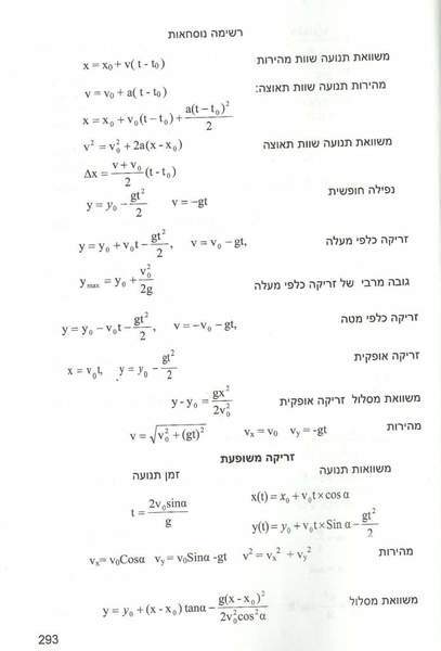

Do these equations belong to kinematics or dynamics? Or both, maybe?
In summary: Initial velocity is the speed at which an object starts moving. Final velocity is the speed at which an object stops moving.
Femme_physics
2,550
I'm not sure how to prepare myself to the new subject, because I'm still not clear whether it's "kinematics" or "dynamics". What is the actual difference between the two? Can I see a difference with examples? (and no, wiki didn't clear it up for me)
I did attach the formulas that we'll probably be using (got it out of the tests solution manual), I'm just not sure which subject do they belong to out of the two.
Kinematics is the description of motion without regard for the forces involved in creating the motion (if any). Dynamics deals with the forces acting on things and the resulting accelerations they produce (think Newton's 2nd law). Many problems involve both kinematics and dynamics.
Those equations you posted look mainly kinematic.
Thank you, I'll go practice me some kinematics then :)

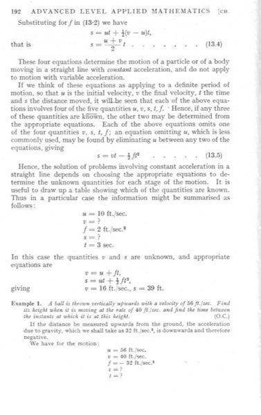

So far I've been only using these two equations. I've been wondering if these are the only equations I need for acceleration/position/velocity problems.http://img831.imageshack.us/img831/4514/using.jpg ----------------------------------------------------------------------------------------------------I noticed that adding this equation below is completely useless since it's basically the same equation as the one above without acceleration! http://img715.imageshack.us/img715/30/noneedex.jpg
I've only been curious of the need to use these two equations below. Should I forgo putting them in my formulas page? They're only confusing me since I've been able to solve 3 exercises ignoring them.
http://img831.imageshack.us/img831/4797/notusing.jpg
I'm not sure what x0 is for, you will never need it if you start at x=0 at t=0
You have 5 quantities to play with.
Time
Distance
Initial speed at time t= 0
Speed at time t
Acceleration
You have to know at least 3 of these which means your require at most three equations.
Most courses use the following (in your notation)
v2 = (v0)2 + 2ax
v = v0 +at
x = v0t + 1/2 a t2
Edit - see post27
Using these three you can take the three given quantities to calculate all possibilites.
As a matter of interest I found the most efficient method for exam purposes was to make the above list of quantities and equations and then 'fill in the gaps in the quantities list' by calculation with the equations.
Notice I said speed, not velocity.
The problem with using x for distance comes when you do projectile motion and need to resolve velocities in horiz and vertical directions.
go well

Oops I guess I'm just having a bad hair day, you need to be told three quantities not 2.
:blushing:
I can't put it better than the sadly now defunct English Universities Press.
Wow, that's a lot of info to shut me up :)
Appreciated.
