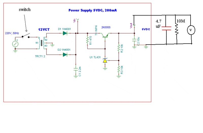

Sorry for bring up the topic again. Was that a battery or a power supply? Power supplies have internal capacitor and also output resistance.
If it was a power supply, then the phenomenon can be explained easily.
It was a power supply.
See what happens if, instead of using the switch on the power supply, you manually disconnect a wire (or both wires) going from the power supply to the capacitor.
The figure shows a typical power supply circuit. Look at R2 and R3 of the circuit. The series of R2 and R3 is parallel with the 4.7 uF capacitor.
When you turn of the switch ( see the location of the switch in the figure), the 4.7uF and the output 10uF capacitors discharges through R1+R2=20K. The time constant is about (10+4.7)*.02=.294 seconds. That's why the voltage drops to zero almost immediately.
Then, the remaining voltage of the internal capacitor C1=2.2mF=2200 uF starts charging the 4.7 uF transistor through all possible resistors of the circuit. Then both capacitors discharge gradually.
The right way to measure the time constant is to disconnect the output. I think the time constant you measured is not the time constant of your parallel RC circuit.

there was no external resistor. The voltmeter itself (the multimeter) has a resistance of 10Mohms. But, what do you mean disconnect the output? Do you mean remove one of the wires leading into/out of the power supply?
In your experiment, the switch must isolate your capacitor from the power supply. The on-off switch does not do so.
In the simplest way, just disconnect one of the wires which connect the power supply to the capacitor. This isolates the circuit from the power supply.
