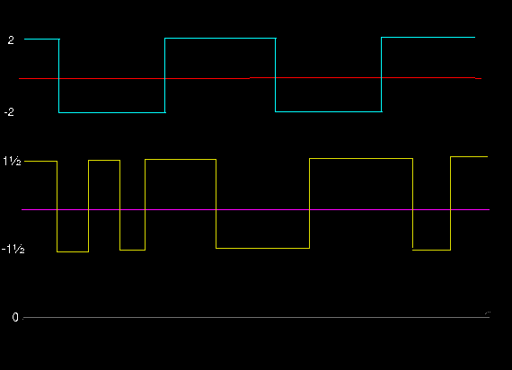

Hi PF,
I have a serious doubt. In spread spectrum modulation etc we multiply the message signal with PN sequence , so as to spread it in frequency domain, good and I am OK with that. But when explanation comes multiplication becomes XOR ing in most books and articles.
How XOR can be replaced at multiplier? :confused:
-Devanand T

This is a little counterintuitive. Here is the deal:
XOR mathematically is addition without carry.
0 xor 0= 0+0=0
1 xor 0= 1+0=1
0 xor 1= 0+1=1
1 xor 1= 1+1=0 (throwing away carry)
Addition is a linear operation only when carry is preserved. Throwing away of the carry
turns xor into a non-linear function. As a non-linear function, it has application in the signal processing function of "mixing". Multipliers are also used for mixing.
Consider two sine waves that identical except 90 degrees out of phase being multiplied. The result is a sine wave at twice the frequency. The non-linear operation of multiplication has caused a frequency doubling.
Now consider what the XOR does to two square waves 90 degrees out of phase. Draw this out for yourself, but you will find that it is a square wave at twice the freq.
The way to reconcile this with the mathematical function of multiplication is to create symmetry by allowing logic 0 to be -1, logic 1 to be +1.
square wave: -1, 1, 1,-1,-1, 1, 1
quadrature square wave: -1,-1, 1, 1,-1,-1, 1
product: 1,-1, 1,-1, 1,-1, 1
Note the product is a square wave at twice the frequency.
(adding them, and keeping the carry, produces a waveform that is not a square wave, but has frequency equal to the input square waves, i.e. no frequency translation)

the_emi_guy's explanation is ok, but I have not attained peace in this matter.Please see the attached image.

dexterdev said:
and XOR is complement of XNOR , both don't seem to follow multiplication.
Task 1: Here are two ANALOGUE signals. On the axis provided, sketch what you'd expect if you were to multiply these together.
Task 2: Sketch these same waveshapes, but this time regard them as logic signals, each jumping between logic 0 and logic 1. Sketch the XOR of these.
Task 3: Compare. :smile:

dexterdev said:
0 multiplied by 0 = 0
0 multiplied by 1 = 0
1 multiplied by 0 = 0
1 multiplied by 1 = 1
This is what I thought binary multiplication would be...
XOR is *not* multiplication. It is addition with carry truncated.
XOR can be considered analogous to multiplication only if the inputs are treated as symmetrical with no DC bias for the multiplication.

011001100 squarewave
001100110 quadrature squarewave
001000100 product (note this looks like product of biased sinewaves, see attached image)
Unbiased
-1, 1, 1,-1,-1, 1, 1,-1,-1 squarewave
-1,-1, 1, 1,-1,-1, 1, 1, quadrature squarewave
1, -1, 1,-1, 1,-1, 1,-1 product (note this looks like product of unbiased sinewaves, 2x frequency, see image)
DC biased
010101010 XOR (this looks like product of unbiased squarewave/sinewave, 2x frequency)

Thanks for the effort...I got inverted waveform with XOR no matter XNOR will help. Thanks a lot... Sir
