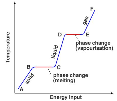

Where this question has come from is a discussion I was having about temperature increase as water changes from the solid to the gaseous state. As the water changes from D to E, If temperature is defined as average KE =3/2kT does this imply that the KE and hence the translational mean squared speeds of the liquid at D and the gas at E are the same if they are at the same temperature?
