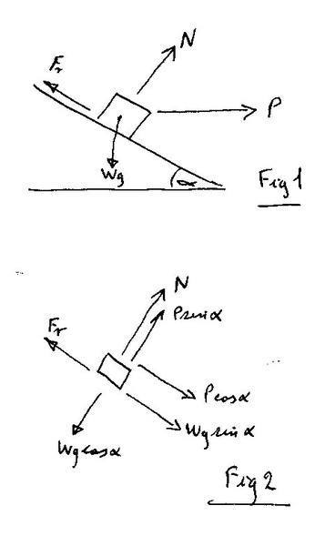

I took your advice and this is where I got. The book gives an answere of 17.2 and I am getting 16.3. What I am a doing wrong?
http://www.streetneeds.com/uploads/auser/statics4.jpg
Please help, I think I am missing something simple.
The force P is pulling the block to the right.
If you resolve this force into components down the plane and normal to the plane, then you should see that the normal component is tending to lift the block up from the plane. In other words, the normal component of P is reducing the Normal Reaction, N, of the plane against the block and this should be taken into acount when caculating the friction force.(F = mu.N)
Similarly. The force P has a component down the plane. So there are two forces acting down the plane, not just one. This fact should also be taken into account when calculating the friction force.
In the attachment, Fig1 is the FBD showing all the forces acting on the block.
Fig2 shows the forces resolved into components normal to and parallel to the slope of the plane.

I got it, wow. that took forever. Thanks for all the help.
