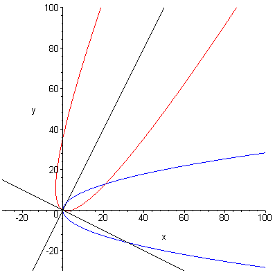

Hey guys,
This is my first post, and I spent a lot of time trying to figure this one out and I am totally stumped! Two of my classmates got different answers, and no matter how many ways i work this problem out, I still get the same answer.
Also, forgive me if my mistake is really simple because at this time last year I was in a pre-algebra class. Now, I'm in precalculus and managing to get an A, but I still make arithmetic mistakes at times.
I hope this attachment works right.
G'day, Beeza.
Your work is great and I agree with you.
Here's what the tilted parabola looks like with the new axes and the untilted parabola.
Thanks for the confirmation Unco! I was hoping that I wasn't crazy
