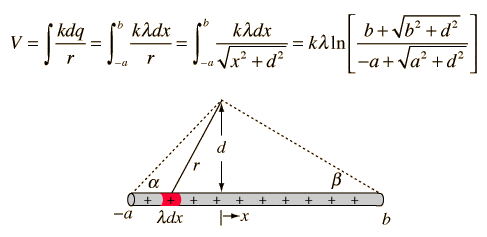

The potential of a single plane is given by basically repeating the point charge equation and leads to the following intergral;
[tex]\int^{a}_{-b} \frac{kdq}{r}[/tex]
The potential on the surface of a sphere is identical to that of a point charge.
-Hoot:smile:
[edit] latex still isn't working so I've included an image from hyperphysics;
If you want more information hyperphysics is an excellent resource;
http://hyperphysics.phy-astr.gsu.edu/hbase/electric/elepot.html#c1
