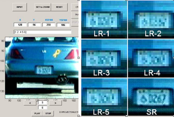

I applied super-resolution techniques to your images but the result was not good. Probably they don't contain enough information when combined to produce a higher resolution image. See attached image for an example of 5 low-res license plate images (LR) and producing a good super-resolution (SR) result.
--Mike

Thanks for tryin, mmccorma, and welcome to the PF. What software did you use?
Jan4-07, 01:59 PM   #23
No problem. I wrote the software and a GUI for super-resolution in Matlab. It finds the integer and then sub-pixel offsets among a set of images using the Taylor series method described in this paper: http://www.ph.tn.tudelft.nl/~lucas/p...IE2000CLLV.pdf
Finding the correct sub-pixel offsets is the key to resolving a higher resolution image. Then it's just a matter of interpolating a non-uniform grid of pixels to a uniform and denser grid.
--Mike

from mike's post I read _D267
with the _ looking like the handycapped tag wheelchair grafic
