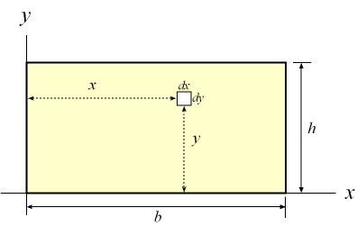

for example from the efunda
after getting Ix and Iy , the total moment of inertia is the sumation of the two I?if weight is added on top of the beam in this example, what will be the direction for the 'stress'?
with given mass, if i want to maximize the moment of inertia mass of an I beam, is it true that the distance between 2 flanges( top and bottom part of I beam) have to be as far as possible?
thanks...
http://www.efunda.com/math/areas/ima...rtiaExpOne.gif
No, that'll be the polar moment of inertia. You have to understand moment of inertia is about an axis.
You mean the bending stress? Draw a moment diagram for this. Along the axis of the beam, there can be both negative moment and positive, which will determine either a clockwise or counterclockwise "direction" for the bending stress along the beam axis. Beams are designed with Max Moments (negatives and positives are taken in consideration).
thanks...
Mass? If you want to reduce the bending stress, you'll need to increase the area moment of inertia of cross section of the beam with respect to the axis the moment is acting. For an I beam this could be achieved by increasing said distance, but you have to watch out for buckling of the web or crushing due to shear stress.
