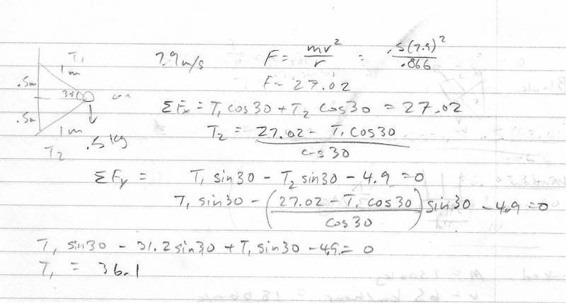

im having trouble with this same problem...
i don't know what I'm doing wrong...
