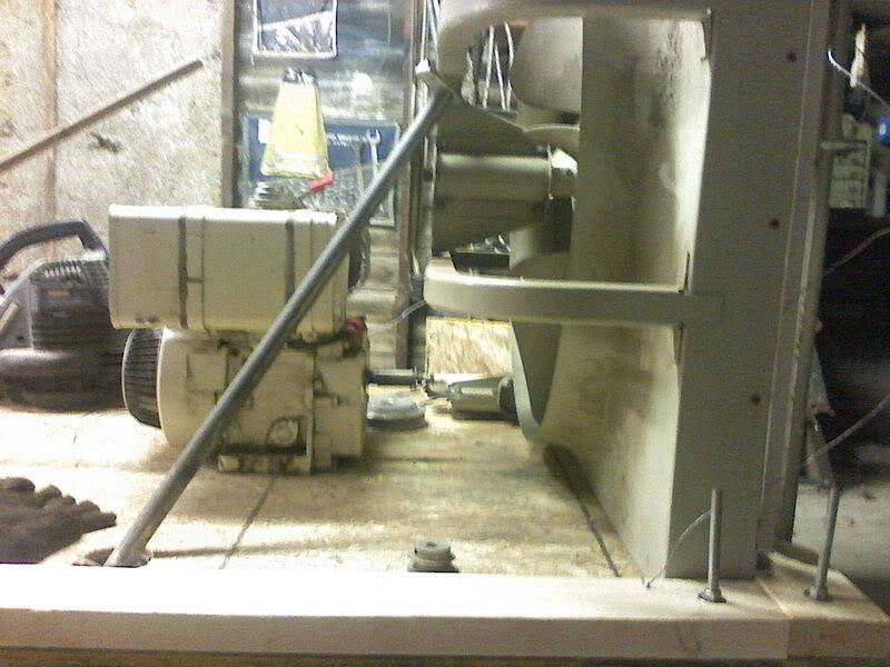

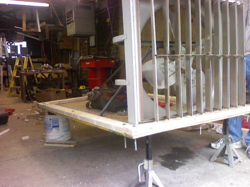

I am doing a riding hover craft and not a R.C verson.
My specs
-4"x6" feet
-11HP engine for fan/thrust drive.
-2 maybe 3 leaf blowers (cant remember the CFM, off hand)
-A 32' or 36' (diameter) fan
-6' in lift (bag filled with air)
I have pics
-sorry some pics are cell phone pics (eeww)

Hey, i have an 11 HP engine which will be driving a fan for thrust via (v-belt). What do you think the best ratio for pulley size would be for the fan and the engine without being too hard on the engine. but will allow a very high RPM for the fan which is about 32' or 36' (diameter).
