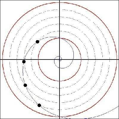

Hello all, I am working on a program that graphs the Golden Spiral and then lays a set of circles on top of it. I was curious to know if there is a formula I can use to figure out the x, y coordinates where a circle of a given radius intersects the spiral. Two assumptions can be made here. The circle's center will always be on the origin of the graph as well as the spiral. I attached a picture of a template with the spiral on it so you can see what I mean. Here is the equation for the Golden spiral that I am using (I added sine and cosine so that I could draw it with rectangular coordinates).
X = Cos (T) * Phi ^ ((2 / Pi) * T)
Y = Sin (T) * Phi ^ ((2 / Pi) * T)
T represents the Time constant but also the angle of the spiral.
Phi is the golden ration which is (1 + Sqr(5)) / 2
And of course, Pi is just pie.
Using that set of formulas, I want to be able to figure out the X and Y coordinates of a point on a circle where it intersects the spiral. I thought I came up with an equation for it but it didn't work... any help would be much appreciated.
One note about the diagram, the black dots are the points I want my program to be able to calculate (I just drew them in the picture to illustrate my point)

The spiral hits the circle of radius r at the (unique) point on the spiral of distance r from the origin.
r^2= x^2+y^2 = phi^(T*4/pi)so 2logr= (4T/pi)log(phi)
so you can find T in terms of r, and hence the x,y coordinates

Now you know what T is - (pi*logr)/(2logphi) - for a given number r this is just another number you can calculate, but not by hand. So you can put this in for the x-y coordinates.

Thank you very much for your help! I finally got the program working correctly now. That formula you gave me to calculate T was exactly what I needed. Then I believe I was thinking too hard when I was trying to figure out how to translate the T value into X and Y coordinates. All I had to do was use the exact same formula I used when I was drawing the spiral graph but just put in the T value and it would spit out my coordinates. DERRR! Did you mention this before? If so, I think I just didn't pick up on it right away. Again, thank you much!
