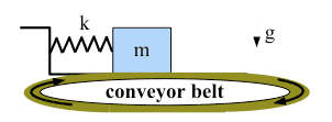

A SHO is resting on a horizontal surface with which it has static and
kinetic friction coefficients us and uk . We have k for the spring constant
and m for the mass. The surface is actually part of a conveyor belt
that is maintained at a speed u whatever the behavior of the SHO. (speed is to the right)
see figure

I'm really only having trouble with the first part. I'm thinking that the conveyor belt picks up the mass due to static friction and carries it with constant speed until kx overcomes static friction at which point there is slipping, etc. Is this correct? and if so how do we explain how it is initially put into motion because we cannot have an instantaneous force brining the mass to u.

I don't know why this was moved to the introductory physics forum. This problem involves multiple differential equations that must be solved with considerations of slipping and frictional forces included.
From the reading of the problem, I don't think it says what you suggest for parts 1) & 2) instead, that the mass is slipping constantly.
I don't think problems like these can be solved using the usual differential equation method.
rather, you should try to explain the motion and connect the pieces together.
first imagine the mass is stationary, it will move at constant speed with the conveyor belt as long as the force exerted by the spring doesn't exceed the static friction. once the spring is pulled hard enough, you'll get some motion. sooner or later, the mass will come around, at some instant, it will move at the same velocity as the conveyor belt, and static friction kicks in, depending on the force at that instance, you will have a couple different situations. you just have to solve for the motions individually and paste them together.
