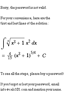

About the 2. In calc101.com result (atach file) diferent only with x^3 (see my version) . So where i do mistake , and in the and have misterios x^3
