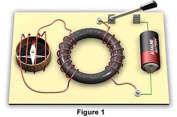

I read a few tutorials on it but I still don't fully understand it.
If my calculations are correct a changing current flowing through the solenoid on the right will induce current in the solenoid circuit on the left which will trigger the needle on the compass to move.
So in this case is the inductance the ratio of magnetic flux on the left (compass) solenoid to the current flowing through the right solenoid?
Would the measure of both flux and current on the right solenoid be called self inductance instead? Since a current is induced on the left solenoid which induces a magnetic field could you call that the self inductance of the left solenoid?
I think I understand why inductance opposes any change in current. Let's say I have a circuit with 50 amps applied to it but the changing magnetic flux induces a counter EMF which brings it down to 30 amps. If I double the initial EMF so I'm applying 100 amps then the magnetic flux will also double along with doubling the counter EMF so the current stays at 30 amps? Is that correct?
Yes, but any current in the left half will quickly cease.
Inductance is a quantity by construction.
It affects current, but is not modified by current.
I suspect you may be confusing turns ratio in a transformer here. This has to do with voltage out of a transformer (the central device) vs voltage in.
Current is controlled by impedance, which can be more or less thought of as resistance.
I have no idea of what you are trying to say here.
Sorry - This is really confused.
You are mixing up the concepts of voltage an current.
EMF is voltage not current.
If you apply 10 volts to the coil initially the reverse voltage will be 10 volts (back EMF) and current will be zero.
If you apply 100 volts to the coil initially the reverse voltage will be 100 volts and current will still be zero.
Ah yeah I got it mixed up. I was trying to understand how inductance is the property of opposing any change in current.
What I was reading is that when a changing magnetic field induces a voltage in a circuit that induced voltage is in the opposite direction of the voltage that caused the magnetic field.
For example I have a basic circuit. I apply 100 volts AC to it. This creates a magnetic field and since the AC current is fluctuating the magnetic field is also fluctuating. This changing magnetic field then induces a secondary EMF in the circuit but this secondary EMF is in opposition to the initial 100 volt EMF.
Have I got the concept wrong?

I think you have half the picture.
You should try thinking of an inductor as an energy storage device.
An inductor will try to maintain the current as the magnetic field collapses.
What happens with a stand alone coil when you open the switch?
Say in your attachment, when you switch off the device, the needle will once again deflect.
But, there is a difference.
What is the difference?
Thanks a lot NoTime. That pretty much explains everything.
