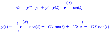

Hi;
This is the general solution for the equation (see LinEq.gif).
Good luck,
Max.
i have the answers in the back of my book. the problem is that i don't understand how to get the wronskian at t=0.
this is a variation of parameters of higher order DE (cookiemonster). Y(t) is the general solution to the homogeneous part of the problem.
It's very nice that you can demonstrate you know how to use Maple, Max, but it doesn't tell you a thing about how to solve the problem.
