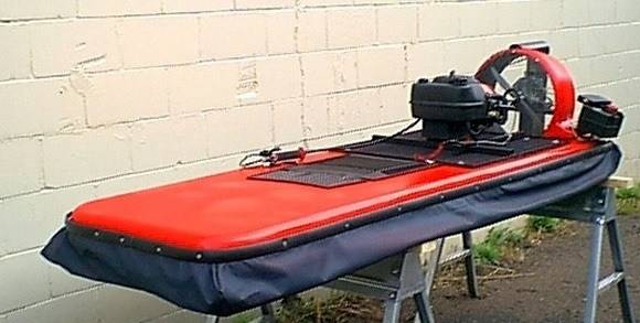

:confused: hi there, I am building a hovercraft in my garage, so far it has gone perfect...
until i get to the thrust part! for some reason i can't get the darn thing to move! for lift i have a kawasaki back pack blower pushing air down into an air mattress with holes punched in it and it works lovely. when i sit on the seat it hovers around my garage seemingly at zero friction. i thought that would be it, but i was wrong... it seems that i could use some big brain help, maybe someone out there has an equation that could help figure exactly how many cfm's i need or rpm's or even something to put me in the right direction. my hovercraft weighs apox. 300lbs with me on it, and like i said could be real close to zero friction at least it seems like it when I am hovering back and fourth effortlesly in my garage. and for the trust part so far i have a 24'' paint booth exhaust fan with a 5 hp engine with ? rpm's . the engine and cowl seem to be very promising but the fan blade doesn't seem to be pushing enough cfm's? idont know if that is even right! but maybe someone does? please help, and remember, I am no physicist so keep it kinda basic for me please! thanks a million

Weight is the enemy, remember that above all.
It's true that with enough thrust you would need no air cushion, and like an airboat you could just overcome friction and move forward.
I have to think that you are not balanced and that part of the hull is making contact with the floor.
Can you set up some mirrors (too see all the way around) and video yourself on the platform to check level?
EDIT: You could tie a string/rope to a fixed stationary point and pull yourself. I would think you could just feel where it's catching.
How about starting with a bubble level on the floor and then on the craft while under power to see if it pitches?
That's a nice looking machine, Fatdaddym.
Remember, though, that exhaust fans are designed for exhaust, not propulsion. You might get by with the same unit if you twist the blades to a steeper pitch.

as far as drag with the skirt, it does okay. as an example, my garage has the slightest grade (for water run off) and whenever i fire up the hovercraft and sit on it i inevitably end up riding that thing out of my garage and down my driveway, and pretty fast i might add. so that is what makes me feel that I am somewhat balanced. still yes sometimes if you lean too far to one side or the other it will create drag, I am still working on that part. as for the string to pull the craft with, my gararge being in a slight grade doesn't help. but my prediction on what will happen when pulled is that it would continue to go in that direction until it hits something that stops it, that's judging by what I've seen it do already. its like being on ice!
That would be correct on a level floor, or going with the slope. Pulling across the slope, though, would result in a diagonal movement as the rope and gravity work at different angles. It would be similar to how you draw a diagonal line on an Etch-A-Sketch by turning the x and y knobs at the same time.
The whole point of the rope would be to simulate horizontal thrust, which in a perfect world would be 90 degrees to gravitational forces. The slope in the floor kind of messes the control situation, best set it all up to go with the flow.
If you are not catching a corner, then we have to assume there is just a lack of thrust here.
I wouldn't recommend screwing with the fan blades yourself. If you unbalance the fan (either physically or aerodynamically) it'll come apart and kill you. And even if you succeed in making it more powerful, you still have only a 5hp motor.
The first thing you want to do is check the specs on the fan: find out what it's design airflow actually is. From that, you can calculate thrust via Bernoulli's equation and that will tell you if the fan is big enough. If it isn't, you'll need a new fan.
A certain 5hp 30" tubaxial fan I pulled off Grainger has an airflow of 16,500 CFM. That's a velocity of 3400 fpm at an area of 5 square feet. That's a velocity pressure of .72", which is .026 psi. 5 square feet at .026 psi is 18 lb of thrust. That's about 1.5 ft/s/s of acceleration. That's not a lot, but I would have thought it would be noticeable. Someone can, of course, check my math...

wasssssuppp, okay here's the deal, I am running a 5 hp b&s engine belt driven to the exhaust fan going from a 1 inch pulley on the engine to about a 2 inch pulley on the fan. i know that i could get more rpms if i match the pulleys or even reverse from what i have now to opposite of that but the fan seems to heavy or something, it works fine until i give it full throttle and the fan gets up to speed, then it looks like the fan is trying to spin faster than the engine or something and it bogs out! my helper at work (who took lots of physics i guess) says that that's impossible. i don't understand why but anyway, my sugesstion to my self has been to just buy a lighter fan blade from a distributer i found online who let's you decide the pitch and diameter of the fan you choose. then all i have to do is unbolt and rebolt! is this a good idea or not? the fans start at around 40 bucks for a fiberglass four blade
http://www.qcsupply.com/Products/11455.aspx?ref=cs
check out the link to the fan i speak of and let me know what you think thanks a lot guys !
fatdaddym said:
5 hp b&s engine belt driven to the exhaust fan going from a 1 inch pulley on the engine to about a 2 inch pulley on the fan. i know that i could get more rpms i...it works fine until i give it full throttle and the fan gets up to speed, then it looks like the fan is trying to spin faster than the engine or something and it bogs out! ...my sugesstion to my self has been to just buy a lighter fan blade ...the fans start at around 40 bucks for a fiberglass four blade
1. Briggs and Stratton 5-10 hp engines are mathed up to 24" fans and 36" propellers all the time for hovercraft lift and thrust.
2. You experience overloading or over reving the fan, more rpms will not equal more power. The fan can only use or absorb so much power before it just goes to waste and spins silly (or bogs out).
3. You have three options, A; slow down the rpm (via pulley ratios) and install a slower moving propeller or fan. B; Make a cold jet with multi-staged fans with stators in between. C; Obtain 2 or 3 more matching fans and belt them togther for a multi thruster configuration.
You have too little fan or too much power depending on how you look at it.

EDIT-1: FDM, Did you know that that fan will only absorb 1/2 of a HP?
EDIT-2: FDM, what was the old paint booth fan electric motor rated at? You might want to get a much lighter gas engine from a weedwacker or leaf blower of similar power rating and hook that up to the existing fan.
Your first reply from a HCA member:
'Hovermaster'
That sounds flat dangerous to me. That fan is likely to explode with that much power. I would just try to explain to him that there are major differences between a household box fan blade and something suitable for a hovercraft.
5 horsepower doesn't sound like much to us, but it is HUGE in comparison to what goes into a household exhaust fan. He could get seriously hurt doing something like that.
Here is what you do with the 5 hp B&S engine, use it for lift on a real hovercraft. A cheaper way to go is to purchase a non-working hovercraft and put new skirt, engines and fans/propellers on it.
