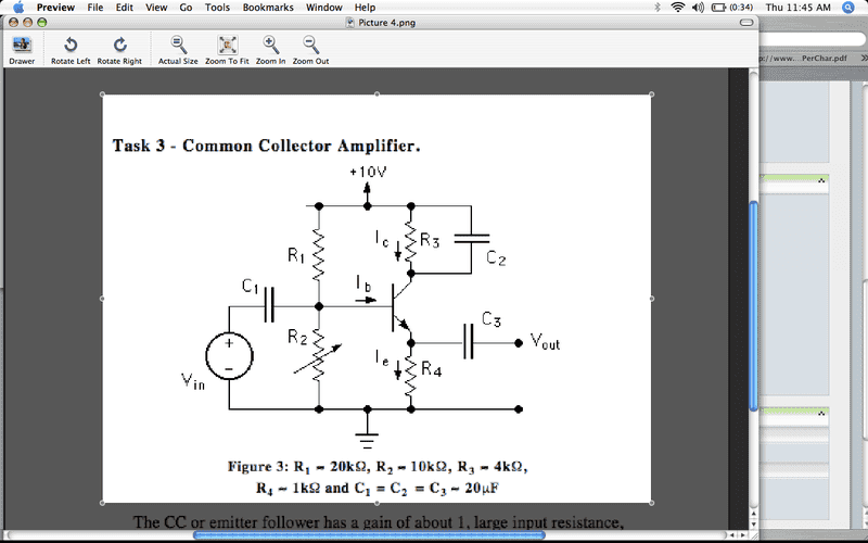

  • A participant describes their intended schematic, specifying a sinusoidal input of 0-20 MHz with an amplitude of 200 mV and a target output of around 3.3V, while also noting a load that sinks up to 1A.
  • One participant suggests deleting a coupling capacitor (C3) to allow both AC and DC signals at the output.
  • A participant expresses uncertainty about which NPN BJTs to use, indicating a trial-and-error approach.

Sure. You want to model a BJT power follower in SPICE? Can you post a copy of your SPICE deck?
im thinking of a schematic like this with vin as a varying sinusoidal input(0-20 Mhz) of amplitude 200mv. I want vout to be reasonably flat across this range.Also at my output id like to have a DC of around 3.3V. It is also worth noting that my load sinks up to 1A of current.Is it worth a shot?
That's a good start for a circuit to simulate, but I'd DC couple the output (delete C3). Which NPN BJTs were you thinking of simulating?
i see...deleting C3 would let me have AC and DC at the output!
as for the type of NPN to use I am not really sure,right now its trial and error
