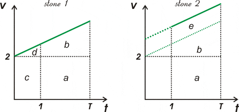

They share the area a and b. So area c and d need to be the same as area e (use the known value of the gradient). Hope it helps!

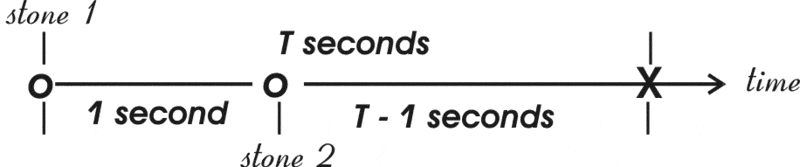

for part b the second stone takes one second less to hit the water, T - 1 (it was thrown one second after the first one - see the attachment).
They both travel the same distance in these times. So you can equate the two
ut + 1/2 a t^2
for both stones. For the second stone u is unknown, and it is the only unknown in the resulting equation.
