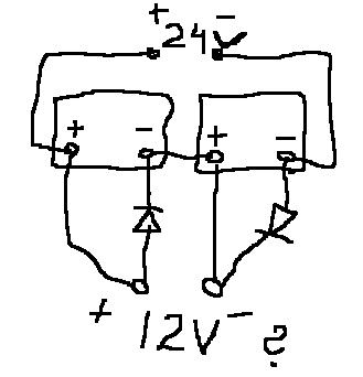

Somebody give me this schema. Is it correctly?
Please check attachment

vars, in that diagram the left diode would heat up and burn out after just a few seconds (depending on how big it is). Then you would just be using the left battery (or what's left of it after it worked on burning up the diode).
You'd be better off using a DPDT switch to connect your laptop adapter to one or the other battery. Again, I'm assuming you're using a car adaptor in-between the battery and the laptop, a 12V battery might be 13.8V (like the powered wheelchair I've tested) at full charge and that might be too much for a laptop straight up without an adaptor. The automotive laptop adaptor should provide the correct voltage to the laptop, regulated and filtered as much as should be needed to meet the power requirements of the laptop, otherwise it might not charge the internal battery properly or cause damage to the unit. Everything has a safe operating range, and you don't want to exceed it by trial and error.

not seconds, but microseconds, with bang, explosion and lots of smoke.
Just tap one battery at a time..

Here's a quick diagram of how to wire up a DPDT to use just one battery at a time. Try to find a DPDT that has on-off-on settings, that way you could disconnect power to the laptop altogether.
